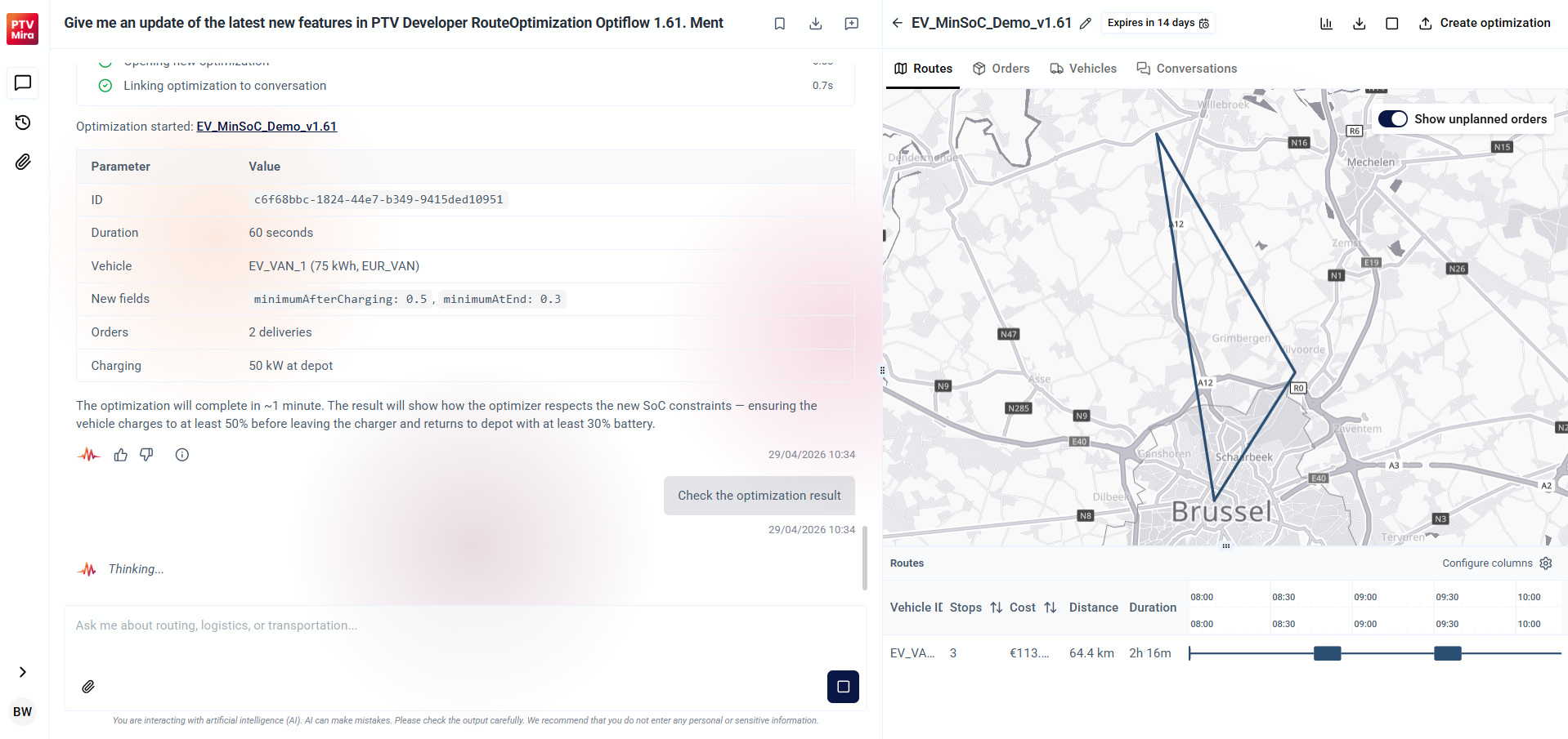

Route Optimization OptiFlow API1.61.0FEATURE28.04.2026Added minimum state of charge constraints to the battery, allowing to define a minimum battery level after charging and at the end of a route.
Here's also a sample request generated by PTV MIRA (check attachment)
