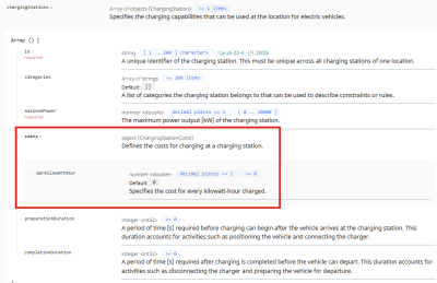

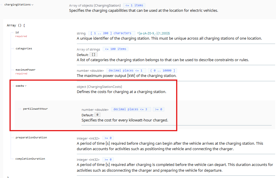

  • Per ChargingStation (1.58 / 14.04.2026):
    • .costs.perKilowattHour: Specifies the cost for every kilowatt-hour charged.

Re: Potential Cost factors in Route Optimization API
Added charging costs in v1.58
Route Metrics:
"metrics": {
        "numberOfStops": 21, "numberOfOrders": 20, "cost": 338.03093333333334,
        "costs": {
          "total": 338.03093333333334, "time": 286.43333333333334,
          "distance": 43.5477, "charging": 8.0499000000000009
        "distance": 124422,"duration": 25779, "durations": {
          "total": 25779, "driving": 11619, "breaks": 3600,   "charging": 360,   "locationPreparation": 4200,"tasks": 6000
        "vehicleUtilization": {"duration": 0.71608333333333329}
