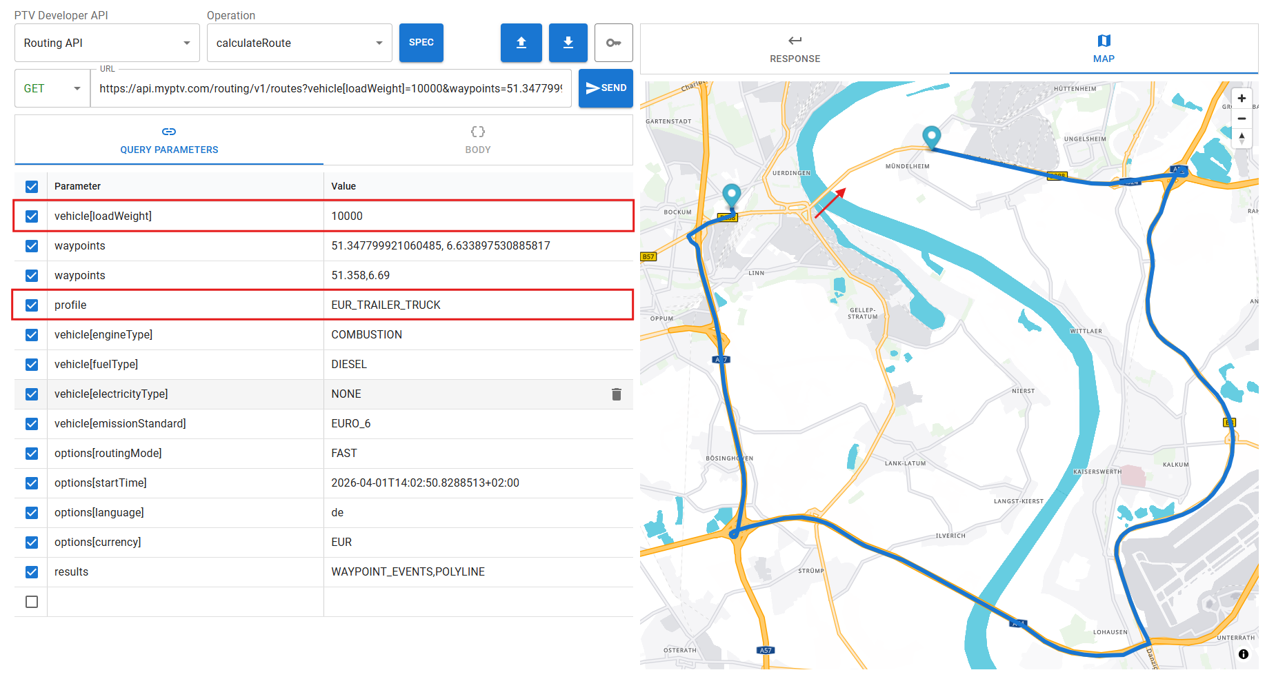

we are currently trying to use the VehicleParameter "loadWeight" to allow vehicles with profile EUR_TRAILER_TRUCK to pass a
bridge with a maximum weight of 30.000 kg by setting the load weight to 10.000 kg, which should result in less than 30.000 kg total weight.
Unfortunately, we cannot produce the correct routing using the following request:
https://api.myptv.com/routing/v1/routes ... 2CPOLYLINE
The only way to take the bridge directly is to use either profile EUR_CAR or EUR_VAN, or setting the TotalPermittedWeight to 3.500 kg, which is obviously no solution.
What are we doing wrong?
Screenshot aus RequestRunner

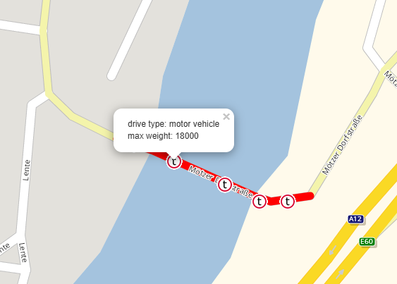

We just tested this for a completely different bridge with a similar restriction and got the expected results. So I guess this is a case of map data error?
Sample request for an 18t restriction bridge in Mötz, Austria:

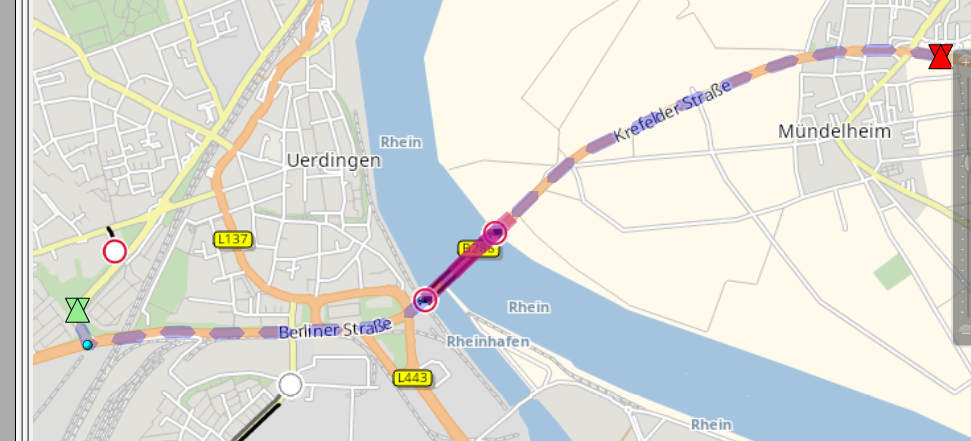

The data on the bridge shows a traffic incident
PTV_TrafficIncidents :
timeDomain=[(y2023M5d17h14m0s59){y7}];
relevantByTime=true;
absoluteSpeed=0;
category=53;
message.text=B288 Krefeld Rheinbrücke - Closed for heavy lorries;
message.language=en;startX=4315432;startY=5549536;
incidentId=204_1;
totalPermittedWeight=7500
There's a long-term traffic incident (17.5.2023 - 17.5.2030) on the bridge - I saw it via a xServer2 test.
As your PTV Developer Routing API request does not specify the traffic mode the default (REALISTIC) applies.
And REALISTIC means "including live traffic"...
That being said you will be able to handle this bridge by
  • either switching to non-traffic incidents mode (AVERAGE)
  • jump into 2030 (after 17.5.)

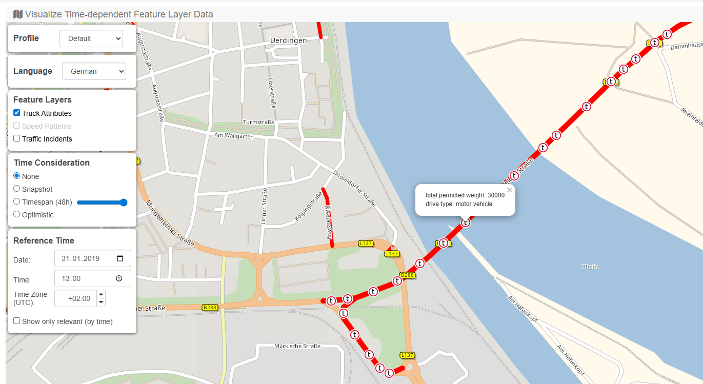

I wasn't clear enough: there's multiple restriction layers on the bridge
  • time-independent "total permitted weight : 30000, drive type: motor vehicle" - applies no matter whether you choose trafficMode=AVERAGE or REALISTIC. So a 40t truck cannot pass the bridge.
  • time-dependent "traffic incident" (as mentioned above) : totalPermittedWeight : 7500... applies only for REALISTIC and when the route is touching the time span of the closed segment.
Does this give a better picture?
Let's set up a session if the answer above isn't sufficient.
PS: I used this showcase for an analysis/visualization
PTV_TruckAttributes: regular restriction is set to 30t total permitted weight
