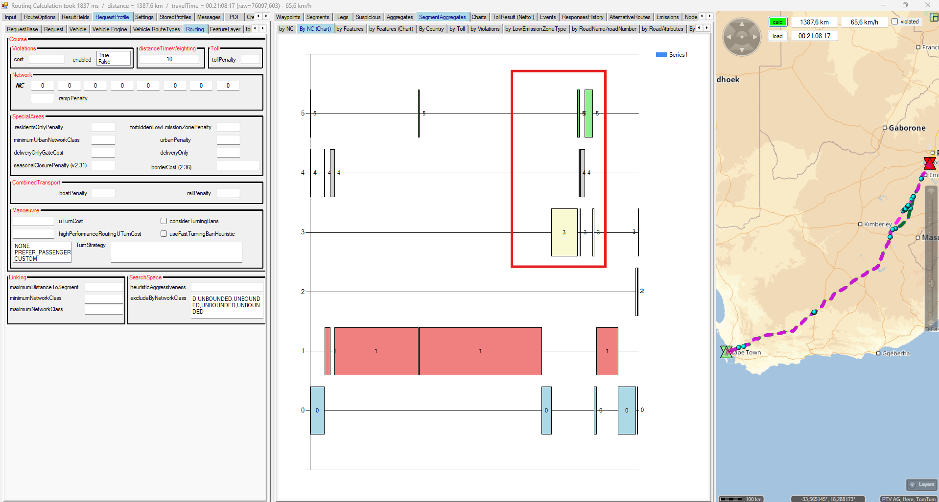

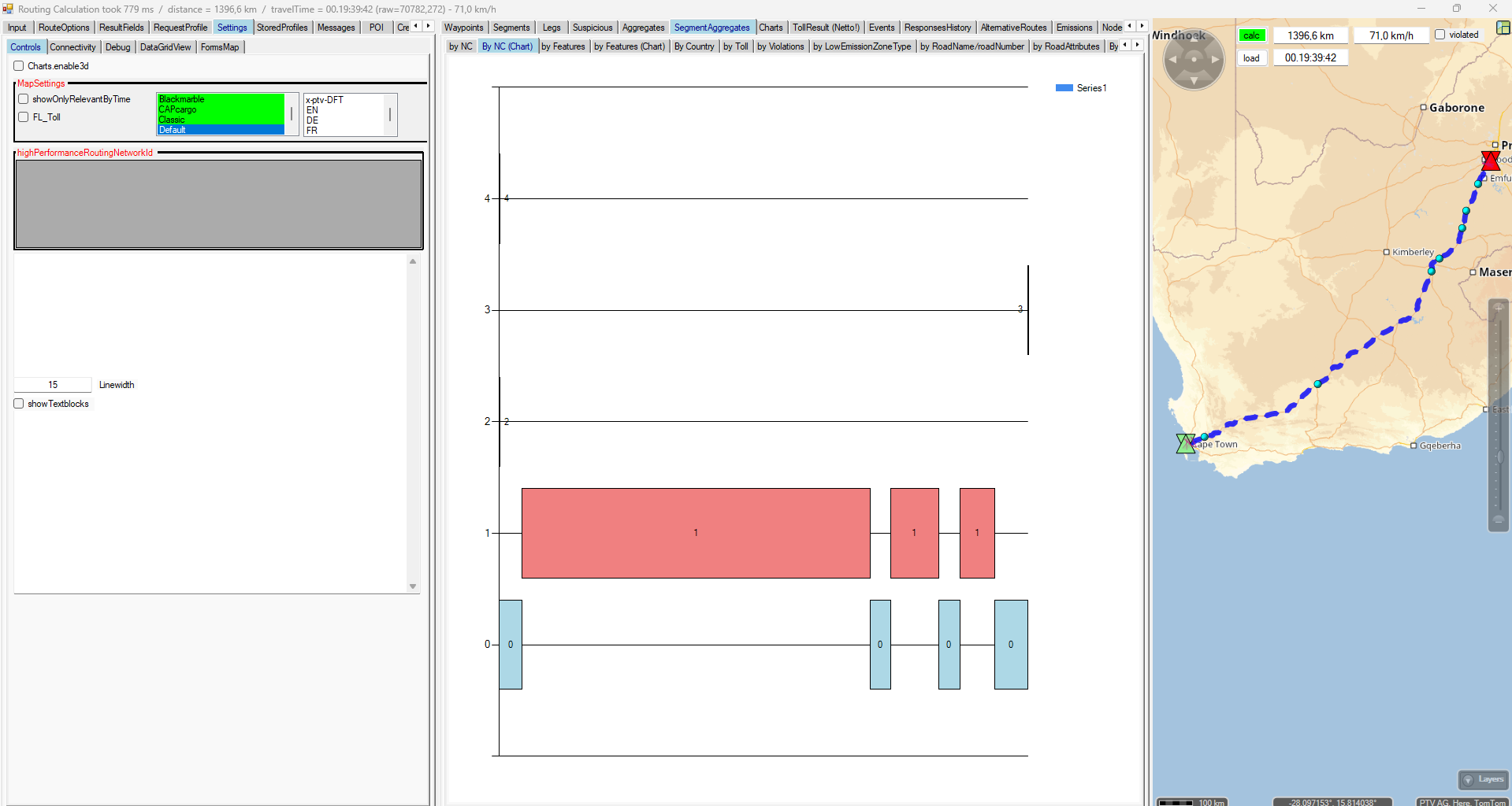

In this route (1396,6 km) I show the network classes used: from left (start) we use the lower classes which is typical in an urban environment. After a certain distance we reach the higher network classes and transfer the vehiclke to the destination area on NC_0/NC_1. In the destination area we use minor roads till we finally reach the waypoint. The routing options in this example were set to standard which means "away from waypoints only use higher network classes" (Leveling is enabled)
The second example (1387,6 km) is "artificial" - I enforced a short route via distanceTimeWeight=0 (not a practical value). Furthermore I disabled leveling (all leveling scopes are set to UNBOUNDED) and I also set the malus values (disliking) to a neutral 0.
I used xRoute2 tools for this theoretical article because the current implementation in PTV Developer Routing API does NOT
  • give access to the underlying technical output (segment lists including the network class attributes)
  • give access to direct API parameters overriding the routing preferences when it comes to network classes
