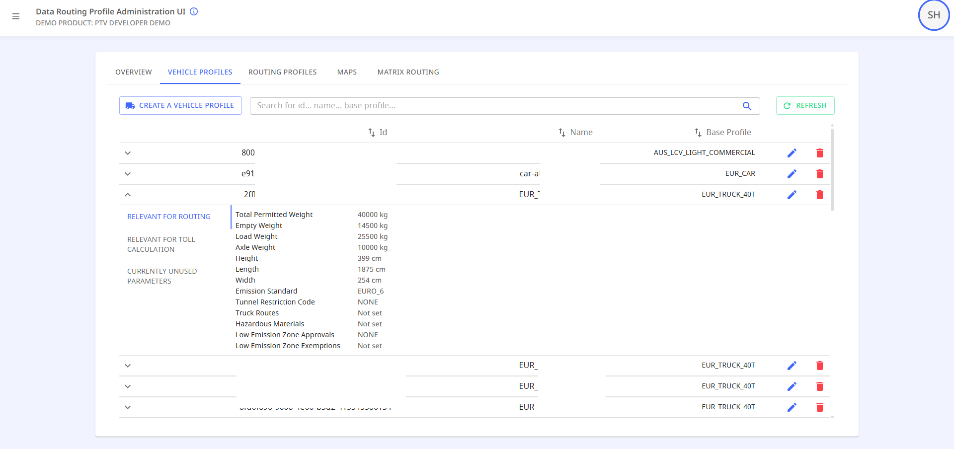

  • maybe multiple base profiles (40t truck, 12t truck...)

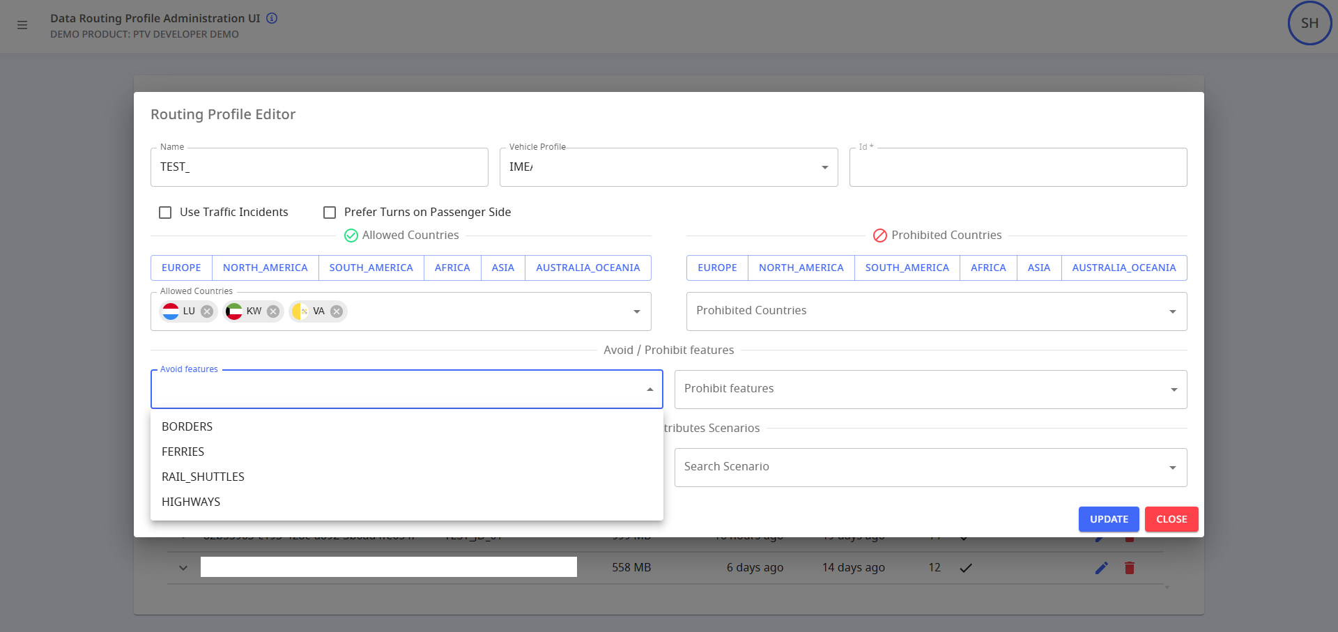

  • cHPR: Technically spoken we have some technology in place which allows us to create custom profiles so a customer can define certain parameters whcih we will use to calculate special HPRs (including also the capability to consider your custom road attributes). But you have to be aware of:
    • These custom HPRs occupy additional ressources (CPU, Memory, DiskSpace) and therefore they come with a price - ask your sales representative to get an offer.
    • If a party needs multiple HPRs this will have an impact on the price.
Once such a profile / cHPR is defined and confirmed you can simply refer to it via its name.
:!: As this approach does only require a user to know the profile name parameter we can also benefit from this through the HSS (SAP's Hana Spatial Services)
