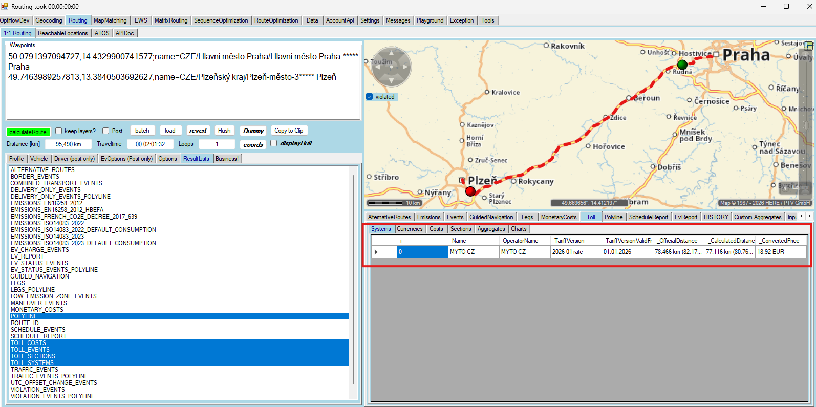

- Posts: 3085
Re: 2026 Hungarian toll increase (HUN / CZE)
Czech toll updates 1.1.2026 are now on Developer!
Dear all,
There is a new detailed toll update available for Czechia.
This scenario contains the new toll tariff in Czechia, valid from January 1st, 2026. Additionally around 50 km of new roads have been added. Accuracy: 90%. Type of calculation: exact.
The layers are activated on Content Update Service (CUS) on February, 20nd, 2026.
Please note: The layers are referenced to Europe/World City Map 2026.2H (251h0) and Europe/World City Map 2026.1H (251f0) so they can only be used with those maps.
