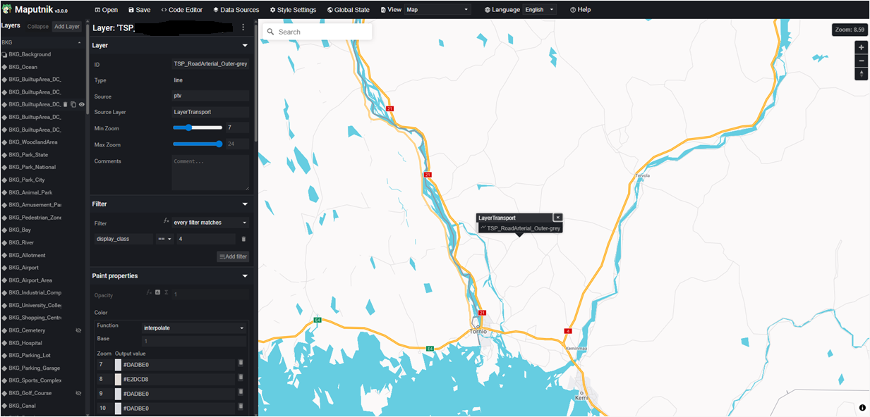

I have played around a bit with Maputnik.
I am looking to show more smaller roads in the map at a higher Zoom level.
https://developer.myptv.com/en/resource ... e-maputnik
The problem seems to be that Vector Maps API does not provide the layer for "display_class = 4" at a zoom level below 8.
Do you know if there is there a way to show "display_class = 4" roads at a zoom level 7 ( or smaller) ?
