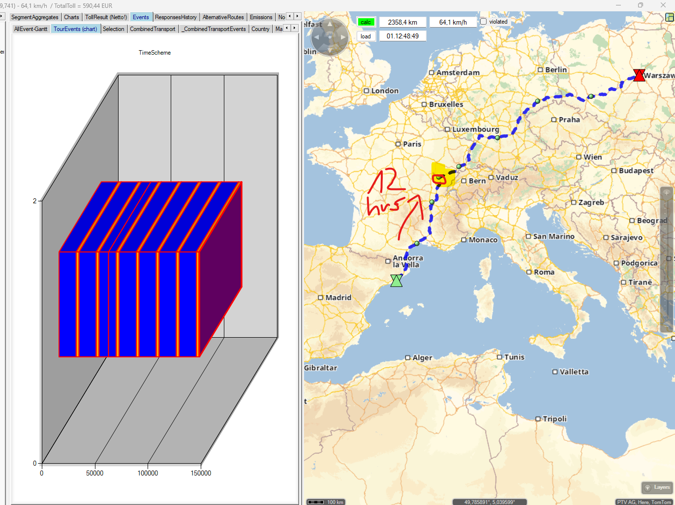

Imagine I compute a long route at 06:00 in the morning. The traveltime for the route itself is said to be 48 hours as it covers an international transport from Barcelona to Warszawa (roughly 2500km, 36hrs bare driving time plus rests)...
Now the driver starts the trip right after the RouteID has been determined.
Will we be able to create the ETA >12 hours after the trip was started?
Or is the ROuteID vanishing and the ETA returns a "routeID unknown"?

12 hours after the driver left Barcelona he reaches Lyon.
