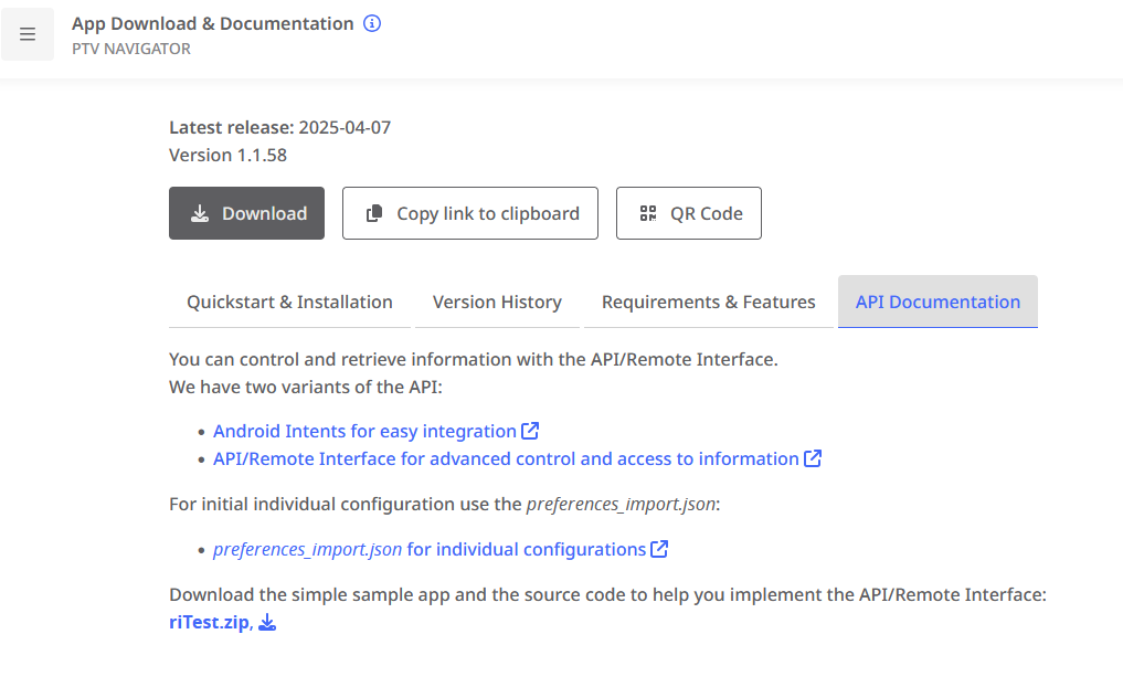

We also provide a test file riTest.zip on the G2 website. This can be helpful during the integration phase.
