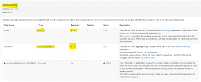

The user works with xRoute2 and calculates toll. In the response he deals with the com.ptvgroup.xserver.xroute.TollSummary which is documented to return an array called costs with a length of 0 or more
Now under certain plausible conditions there might be no contribution of toll in any of the used countries and he would expect some

This behaviour is in fact documented in the technical concept on requests and responses under the paragraph "Response structure":
Noteworthy about result lists: Empty result lists are omitted from the response. Depending on the used client technology you might have to check if a list exists before iterating over it.
