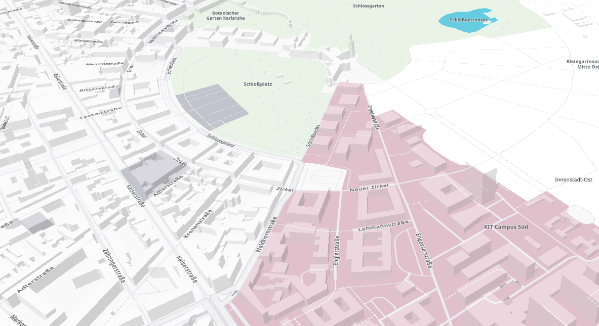

Re: PTV Developer Vector Maps and Microsoft.NET?
and yet another sample. This time showing WinForms integration via WebView2 and interactive routing with maplibre-gl-directions.
