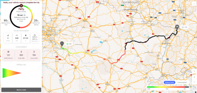

Hello Oliver,
On the EV route planner showcase I've seen some gradient polyline:
Can I apply such a style to a Ptv.XServer.Controls.Map.Layers.Shapes.MapPolyline?
How?
Polyline with gradient line

Re: Polyline with gradient line
i don't know this app in detail, but i would guess it uses MapLibre gadient lines. You can do fancy stuff with MapLibre
For WPF i found an old article from Charles Petzold, which in theory could be applied to the map control. There's another sample for custom poly lines with arrows along the line. I guess it could be adopted for gradients in a similar fashion. But this would require some deeper knowledge of the Control/WPF.
