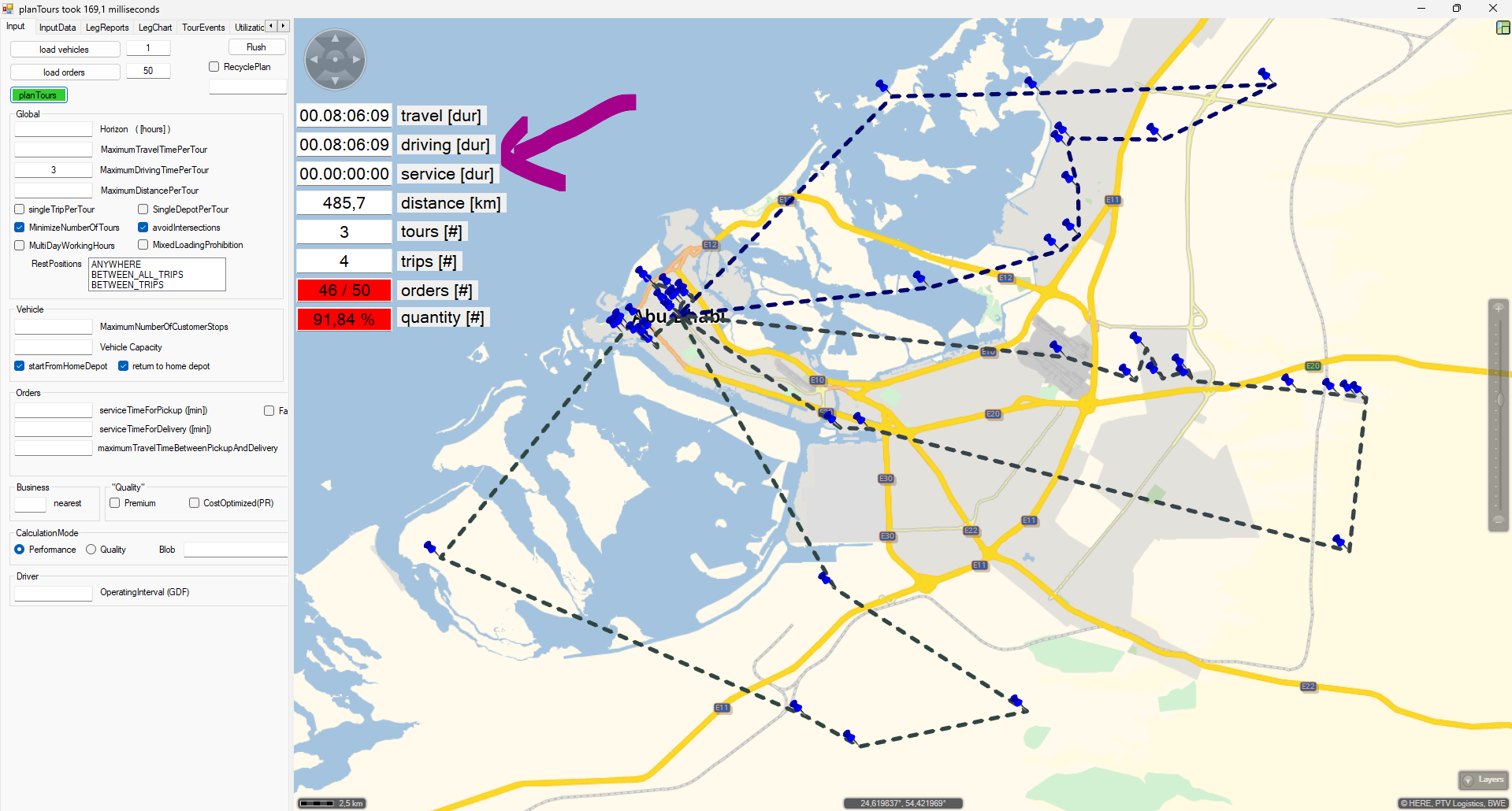

And here's an example:
Though the geographic situations are getting better the number of trips increases from 3 to 4 by requesting "AVOID_INTERSECTIONS"
