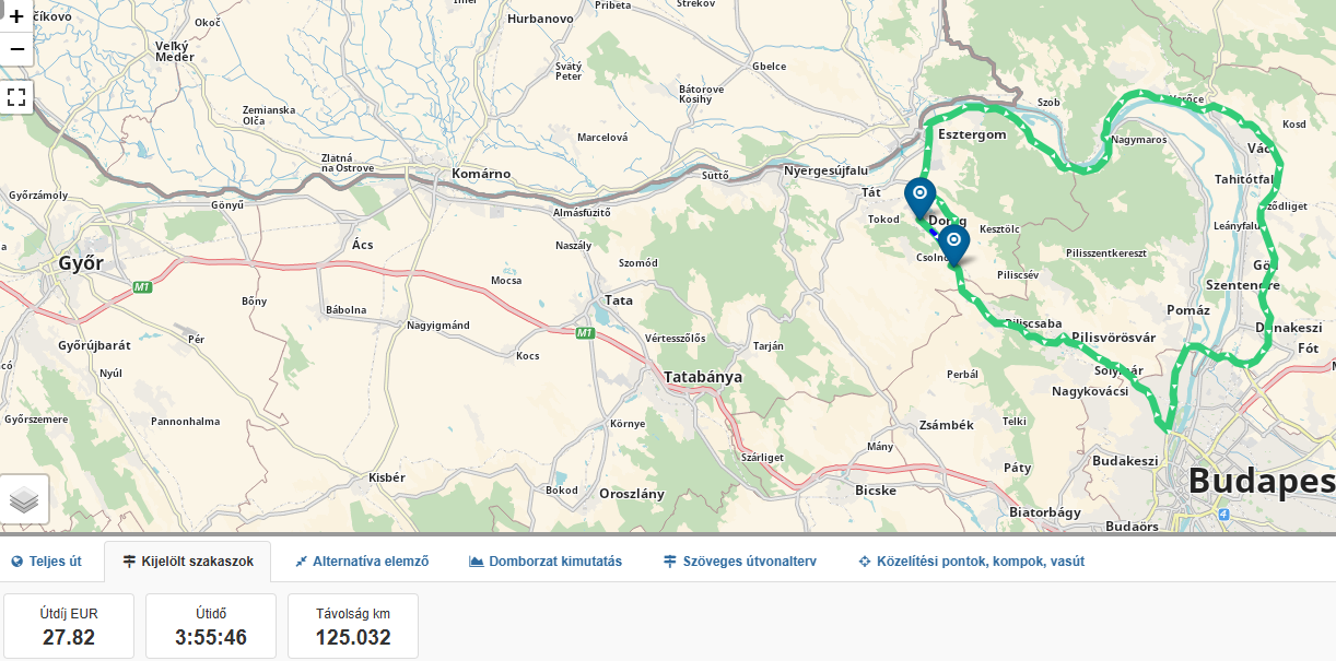

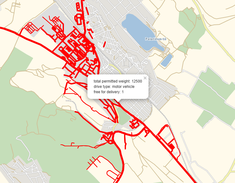

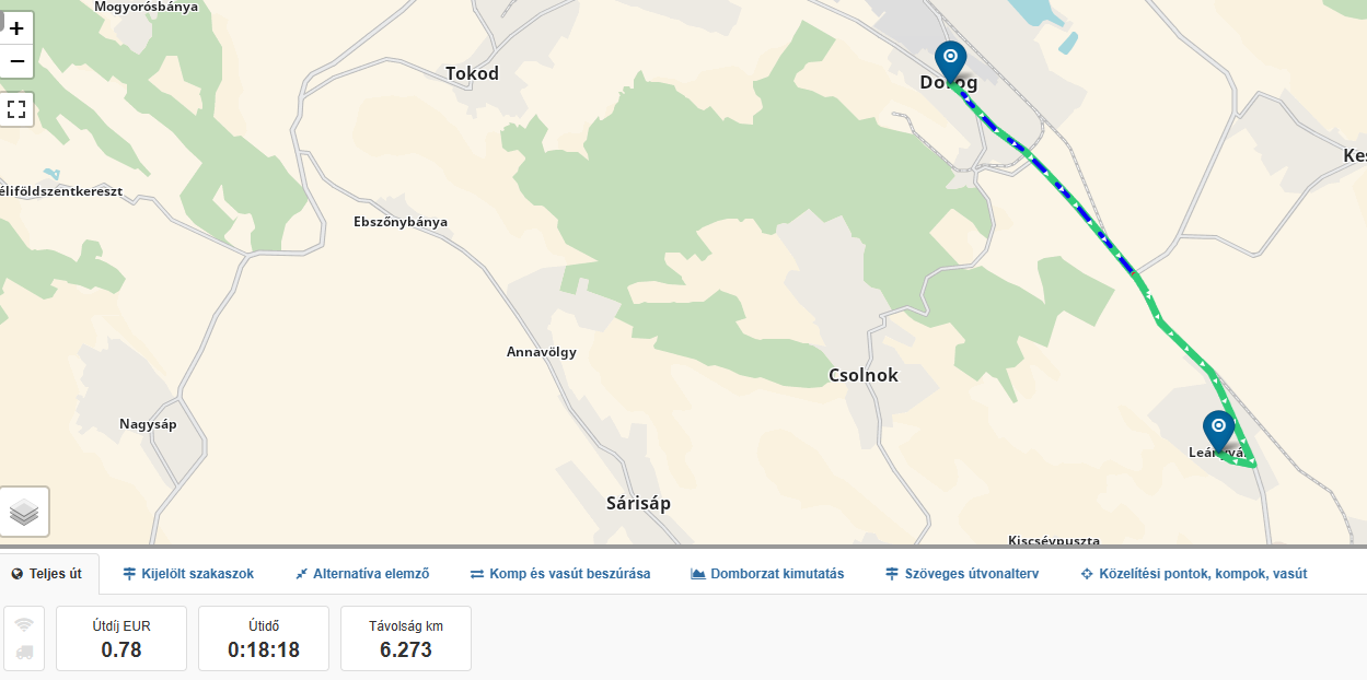

The example route is from
HU 2510 Dorog
HU 2518 Leányvár
In xS1, if we enabled the violations, we get a very short, 6 km route.
However under xS2, we also enabled the violations, yet we get a very long route, around 125 km.
I've attached some pictures from both of the routes and also attached the xS2 request.
I think that we're missing something is the xS2 request, but I just can't figure it out!
Please, check this for us!
Thank you so much,
Peter

Re: Difference in the handling of violations between xS1 and xS2
Hi Peter,
can you provide more information on the xServer version and map, that you use? For both xServer 1 and 2. We would need that information to verify that it's not just data related.
Also, and I know that this is tedious to do since there is not always a direct mapping between xServer 1 and xServer 2 profiles, but can you verify, that there are no obvious and big differences between the profiles?
I ran your request with the current 2.34 on the 2025.1H map and the route that I get is not violated. In Dorog there are a lot of restrictions, but delivery vehicles just get a high penalty and not a violation. The penalty in this case is 2500. I also noticed that you customized the network class penalties. Network classes 5 to 7 get a penalty of 2500. While I understand the reasoning, those are very high penalties, equally as high as the penalty for that truck attribute. As the route calculation optimizes for minimum costs, it tries to avoid such highly penalized segments. The higher the penalty, the bigger the possible detour.
Reducing the penalty for network class 5 to, for example, 1000 gives a shorter route with a local detour. It's not the same as in xRoute 1, but a lot better.
