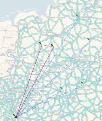

at least your request seems to be valid - I can process it successful through some test client.
I will forward your IDs to some DEV colleagues. We will get back to you 1:1 I guess ;-)
