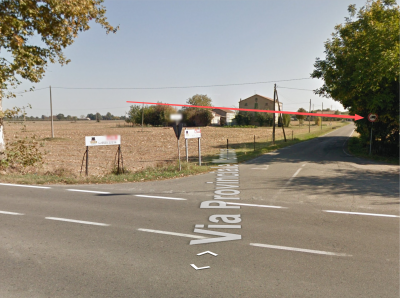

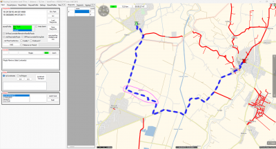

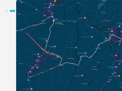

We yet approached another issue with planning a route. There is a part in Italy from Moglia to Concordia that PTV allows to go through a restricted road. Also a closer look with street view attached. Truck should be directed through marked road in dashes.

red lines: various truck attributes in the region.<br />Purple area: the area where some attributes are missing?
