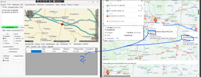

PTV Developer.Routing API call (add your API key)
Left: output of PTV Developer (and xRoute 2)<br />Right: output of HERE<br />There are two more large contributions in the HERE output
Now as you can see there's a significant gap in the prices returned by the two engines. And that is because of different design of the engines when it comes to the handling of "open toll sections": an open toll section is a section where you have to pay a given unique price no matter at which exit you leave the highway. Now here's the thing:
  • The HERE api decides to add the contribution of the A2 because the section in charge is entered.
  • The PTV api decides NOT to add the contribution of the A2 because the section in charge is never left ;-)

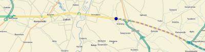

The route ends ON the highway.
Tricky, isn't it? So the next question is "does it make sense to compute a route where the end of the track is on a highway?"

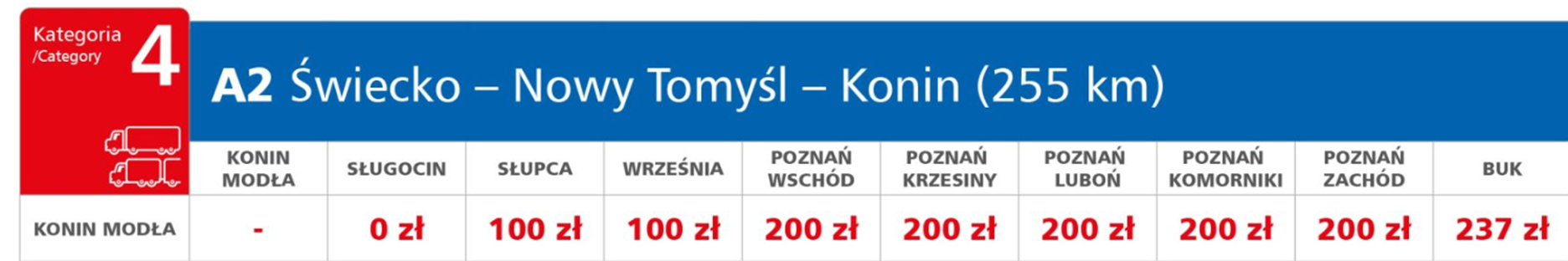

Official tarrifs taken from https://www.autostrada-a2.pl/en/tolls/tool-rates-cat-4/ <br />No matter whether you leave the A2 at Slupca or Wrzesnia: same price.<br />No matter whether you leave the A2 at Poznan Wschod, Poznan Krzesiny, ... or Poznan Zachod: always 200 PLN...
