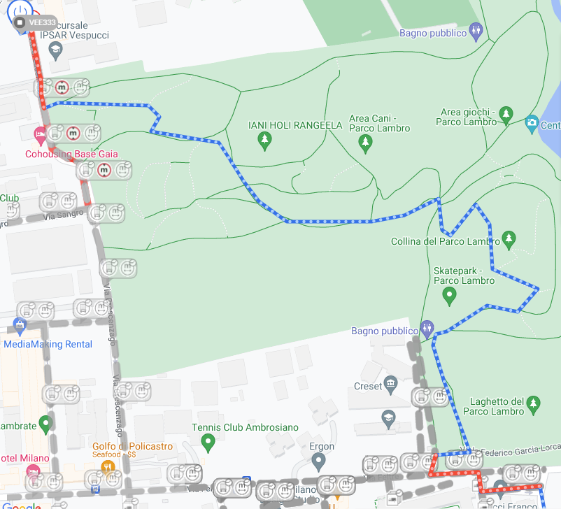

We have had an interesting case where a vehicle was guided through a prohibited pedestrian area.
Our guess is that the issue appeared due to the timed vehicle length restriction. As there was no way for PTV to calculate the route on a non-restricted area (the length restriction is on the starting point, end point and the surrounding area), the algorithm looked for the shortest route across the prohibited area, therefore, a route through the prohibited pedestrian area was calculated.
Is it possible to somehow increase the penalty of entering a prohibited road, so that the algorithm would calculate an alternative path which would go through the length restriction, rather than the prohibited road?
A reference screenshot is attached.

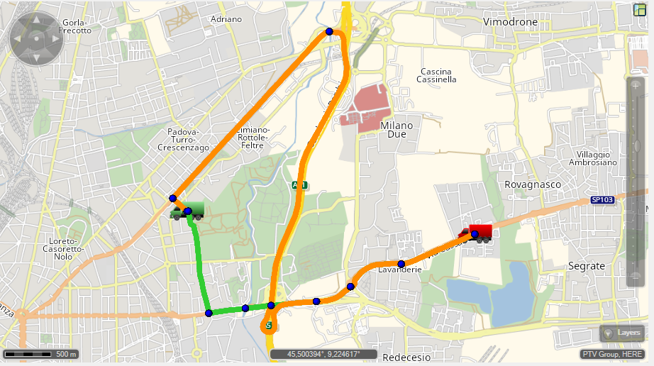

Hi Vytennis,
can we look into this together?
I'd like to check this via a teams session... Please book a slot through the booking portal
