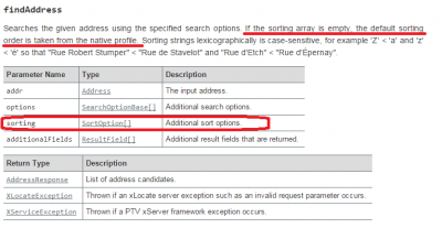

Hello Kevin,
the sorting order is preconfigured in the server side profile but you can override it via the optional parameters of the method.
See attached screenshot!

Re: Consistent Lat/Long results returned?
Well, sounds like a different question...
As long as the server uses same map data (same provider, same annual version) and configuration the same input should generate the same output.
The default sorting order as it is part of native-default.xml is
So from my point of view this should be "deterministic" if you don't change the sorting order within the request and you apply equal search options.
Is this sufficient?
