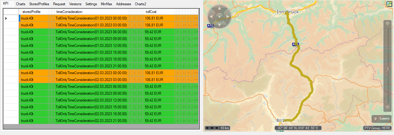

  • The API itself already offers access to so-called TimeConsiderationModes which enables users to specify how the engine is supposed to deal with time dependent data - whether it is daytime dependent speed patterns, live traffic data or toll data:
    • short term within a scenario (e.g. cheaper prices during the day)
      Example of short term price change: daytime dependent toll on the Brenner

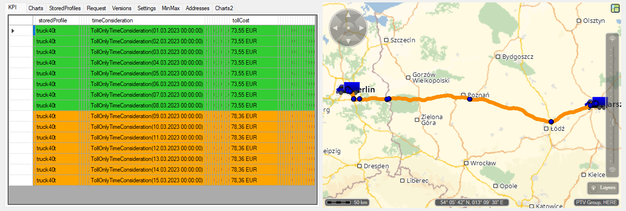

    • long term with different scenarios
      Example of different time based tarrifs: increase of polish toll (change on 9.3.2023)

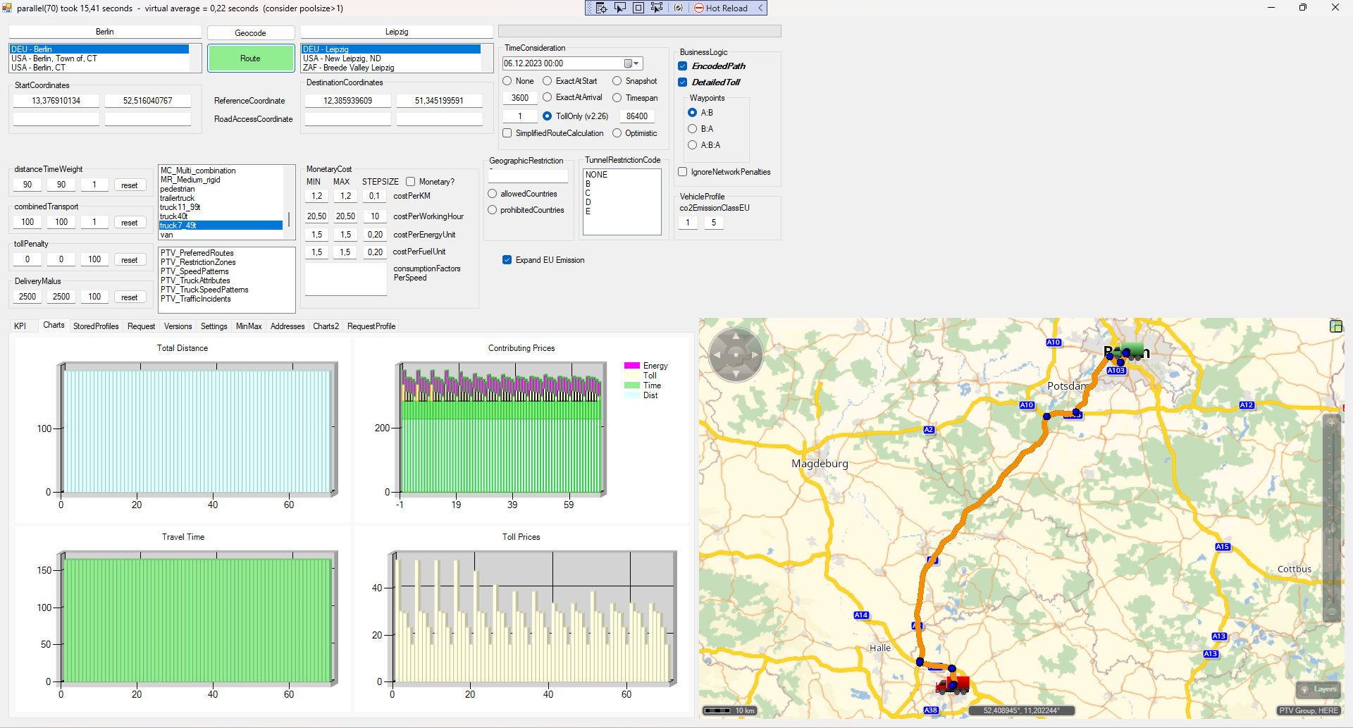

Relation "Berlin to Leipzig" based on 6.12.2023 iterated over all possible combinations of "Euro class" x "CO2EmissionClass" : 40t

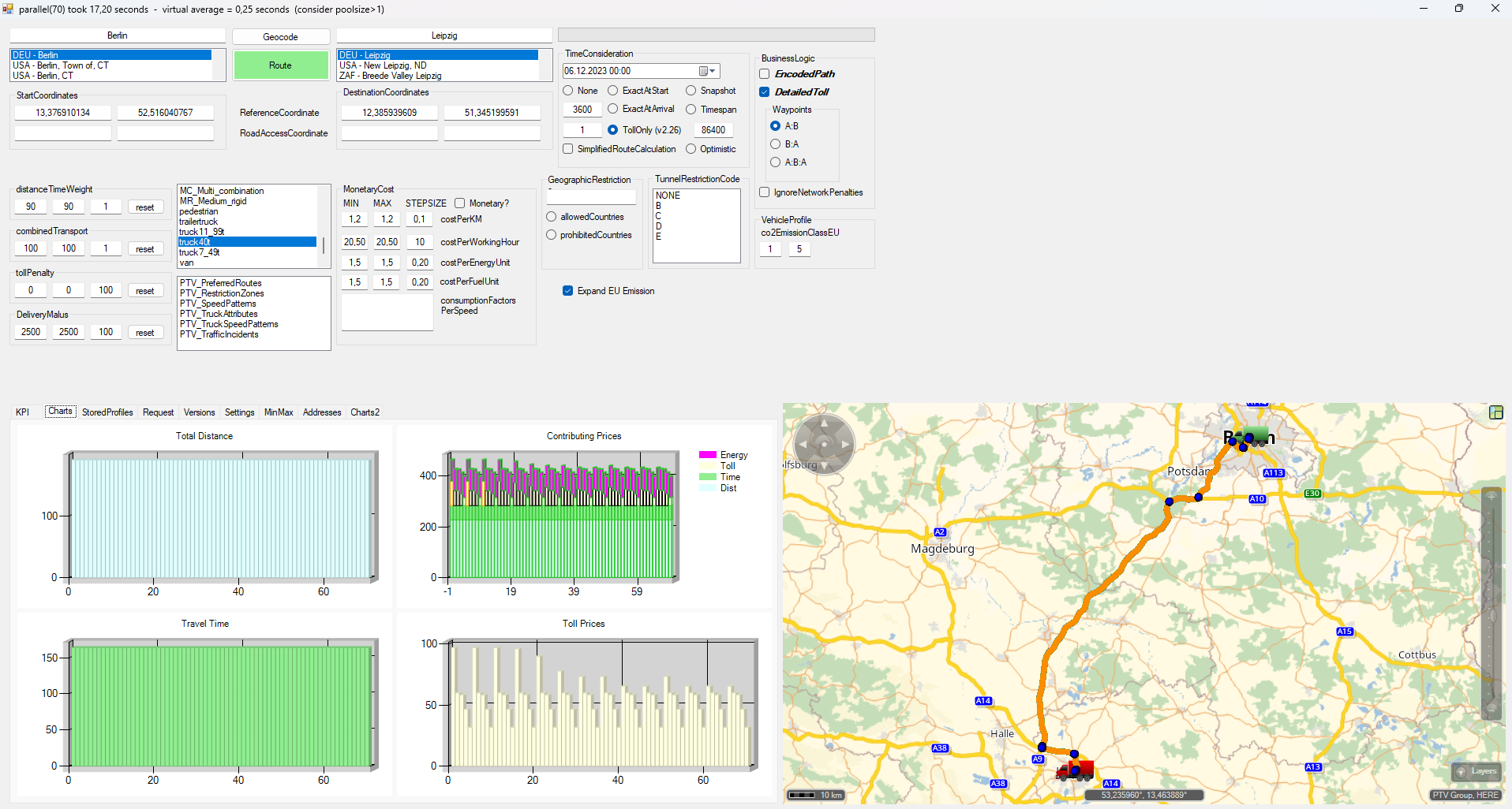

and for the 7.50t Truck (not the regular 7.49t)- just needed some minutes to add this into the client ;-)
