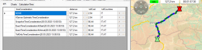

The following output shows the impact of the TimeConsiderationMode on the toll prices:
With NONE and Optimistic you'd miss the significant contribution of some toll segments in Austria.

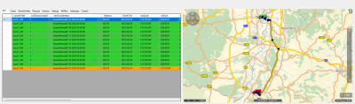

Example for future toll calculation. Based on a monthly reference date the prices change from december 2023 when Germany increases the tariffs for various vehicle categories.
In this example for a 7.5t vehicle you can see the increase of toll for smaller vehicles from 1.7.2024
