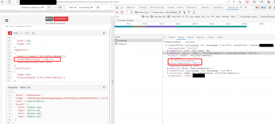

It seems that there isn't any property for the preferredRouteTypes, I tried to analyze and find a way how to send the preferredRouteTypes which should be visible on the map, but I cannot provide this info from our c# code.
About the Feature layers it is ok, and it works correctly, the PTV_PreferredRoutes layer is enabled but all preferredRouteTypes are visible.
I can see that this property is part of the mapOptions but I cannot find this one in Xmap2LayerFactory and in the other options that I have from this dll.
Do you have any idea to share with me, how to enhance the request with this property and how to provide additional information about the preferredRouteTypes that we want to see on the map?
I know that when we use REST API to build a tiled map if we want to display only a subset of types - the parameter preferredRouteTypes has to be specified in the URL and the types have to be included with comma separator.

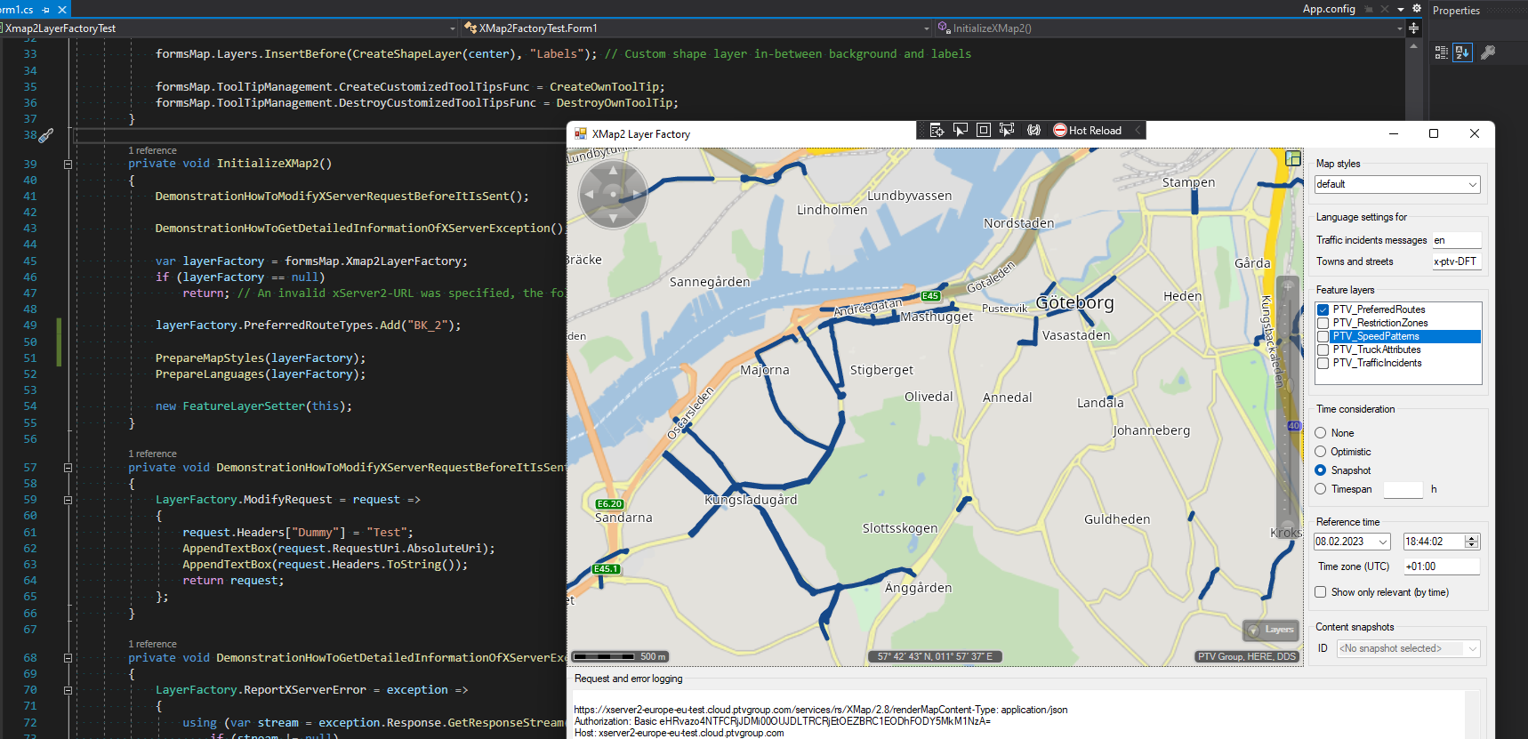

looks like the preferredRouteTypes cannot be set by the layerFactory. Though there's a ModifyRequest event, but this is more intended to add http headers.
I have added a new property, so you can set it like.
layerFactory.PreferredRouteTypes.Add("BK_2");
If you want it as new nuget update, this would require a new release.

New version 1.7.10 is available per nuget ;-)
https://www.nuget.org/packages/Ptv.XServer.Net.
Thanks to Oliver for the quick release!
