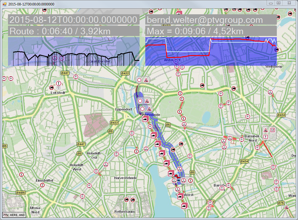

for those who are dealing with time dependent routings: I created a little testclient that may be helpful for evaluation of time dependencies. It computes the route with a fixed waypointlist and an interval of various daytimes.
Besides the changing routing geometries in the map it visualizes the dynamic character of those routes via some histograms:
left diagram: the current route's speed pattern<br />right diagram: red line change of driving period over all routes, white line change of distance over all routes
The reason why the difference between various scenarios is so big is the Sierichstraße in Hamburg: it is a dynamic one-way street that changes directions twice a day (04:00am and 12:00pm).

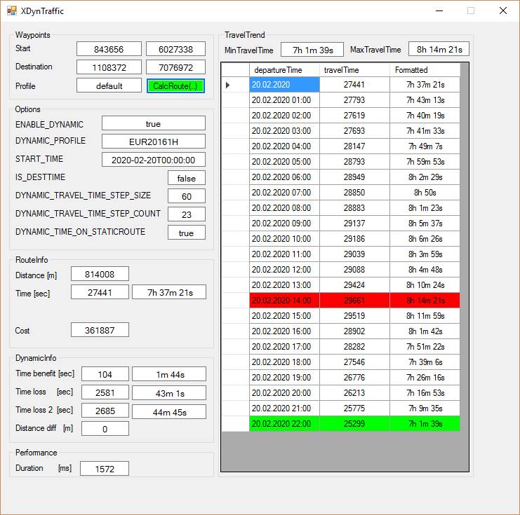

Here's another test output based on SpeedPatterns
Driving times and distances in 1hour steps
