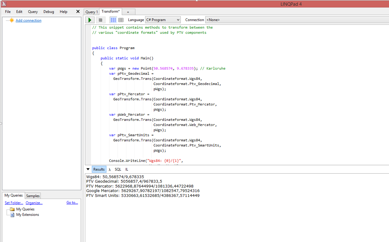

We are implementing our Transport Management System at a new customer. This customer has his addresses already Geocoded in Lat/Lon format. Our transport management solution uses the xLocate feature to GeoCode addresses and xMap to plot them on map etc. The customer asked how to convert his geocodings (done by a paid service provider) to PTV Mercator format?
This code snippet on the web https://gist.github.com/oliverheilig/7029947 lead me to the PTV Spherical Mercator actually is the EPSG:505456 format. With a freeware tool http://www.linqpad.net/download.aspx I was able to migrate based on the formula provided in the code snippet.
So far the testing results are quite positive. Is this the preferred way of handling this? Or are there more intelligent features in the xServer suite capable to convert? Of course we could simpy re-geocode the addresses but then we would loose all the information and work already put in the geocoding. From the other side, when calling the geocoding again, you are sure all addresses are correct against the current map...
