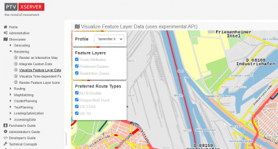

the native rendering parameters are stored ina an ini-file (e.g. "tarender.ini") which is supposed to be stored in the /conf/profiles subfolder. You can then refer to the ini file through the server's stored profile
The profiles will be offered in the mapping showcases, too:

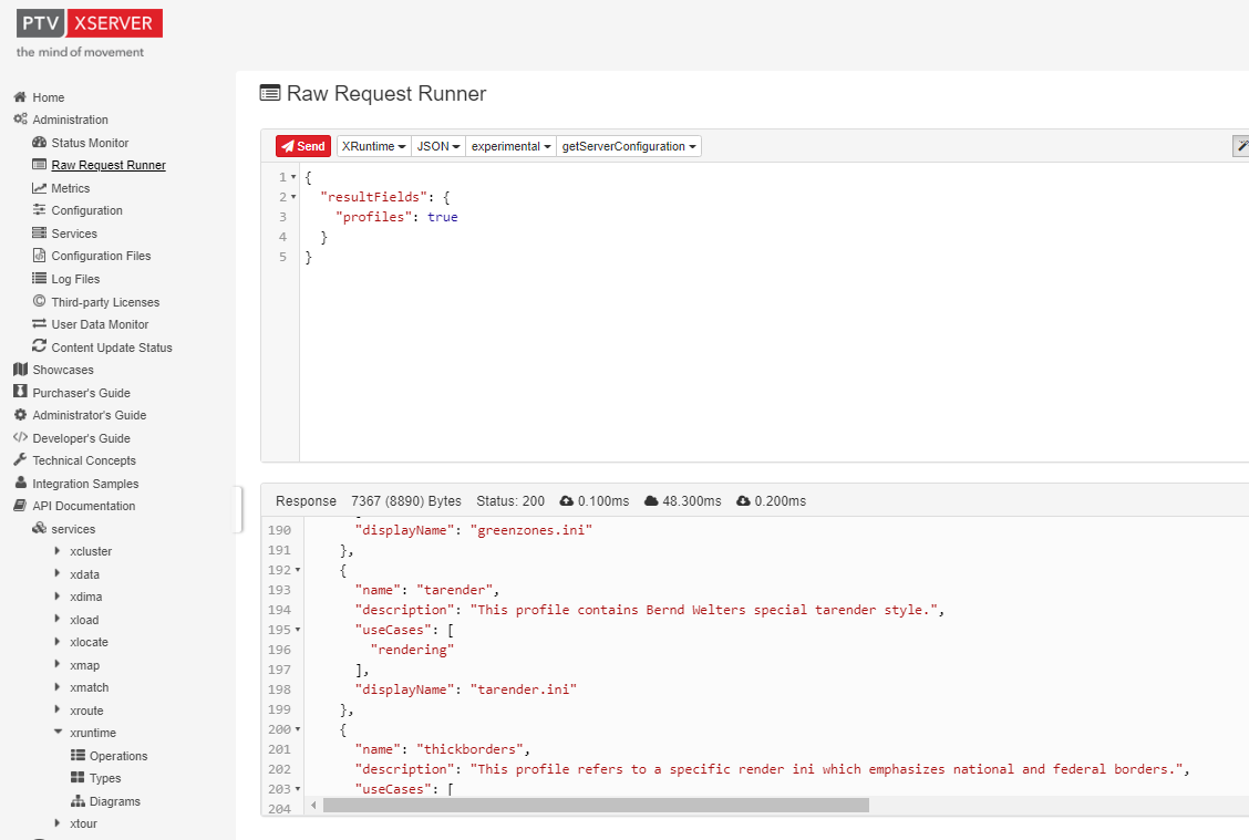

And you can gather the description via the xServer2.getServerConfiguration API:
<profile version="2" dataCompatibilityVersion="2" parent="featurelayer/fl_*"
useCases="rendering" displayName="tarender.ini">
<description>This profile contains Bernd Welters special tarender style.</description>
</profile>And you can gather the description via the xServer2.getServerConfiguration API:
