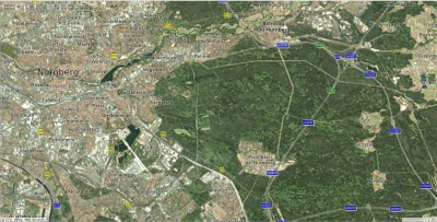

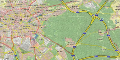

we test the Here Satellite Images in our program. When i only activate the Here Satellite Images, it works fine. But when i activate the Featurelayer PTV_Truckattributes too, the background of the Truckattribute lies over the Here Satellite Images (see attachment).
Is there a posibility to deactivate (transparent) the background of the Truckattribute-Layer. I tried it with the profile silksand.ini, because the name of the featurelayer-profile is silkysand-fl-truckattributes.xml, but it doesn't work.

I received an explanation from one of the experts - enriched by a statement by myself:
The described behaviour is caused by a technical restriction within FeatureLayers:
FeatureLayer lines will only be drawn if streets are visible. Therefore the Ajaxmap is implemented as follows: if a FeatureLayer is active use the Ajaxmaps background profile instead of the foreground profile (which does not display streets). This causes the side effect of the non transparent layer which overlays other layers, e.g. the satellite layer.
A potential resolution for this behaviour within xMap server itself would be to remove the dependency between visible streets and feature layer lines. I already asked Product Management whether this
- is fixed
- will be fixed (and when)
- won't be fixed (because Ajaxmaps are more and more replaced by xMap2+Leaflet)
Please be patient,
- is fixed
Please be patient,
