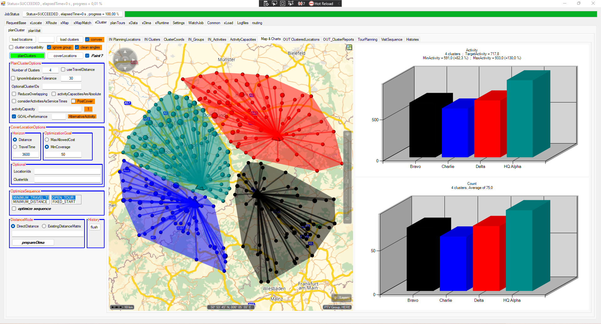

Trivial assignment. Each customer is assigned to the closest input territory center. The activities of this result are between 80.4% and 131.9% of the target.

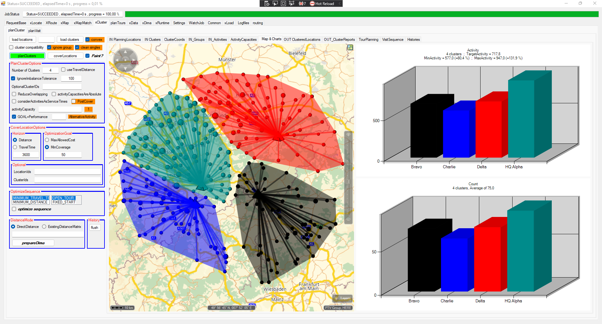

Getting same responses every time with below combination:
1. imbalanceTolerance=10,50&10 and ignoreImabalanceTolerance=false
2. ignoreImbalanceTolerance=true
But getting different response with combination imbalanceTolerance=0 and ignoreImabalanceTolerance=false.
Please let me know, why similar response is generated with above mentioned combinations? I am expecting different responses with different tolerance values.

Trivial assignment: each customer is simply assigned to the closest cluster center.
This is how we create a kickof "condition" which we would try to improve if it violates the imbalanceTolerance.
  • In the customers example the Trivial assignment satisfies all the imbalance tolerances [100%,50%, 10%] so there's no need to improve the trivial assignment.

By setting the tolerance to 30% (just a little below the deviation of the "trivial assignment" I push towards "iteration". The result is now between 80% and 130%

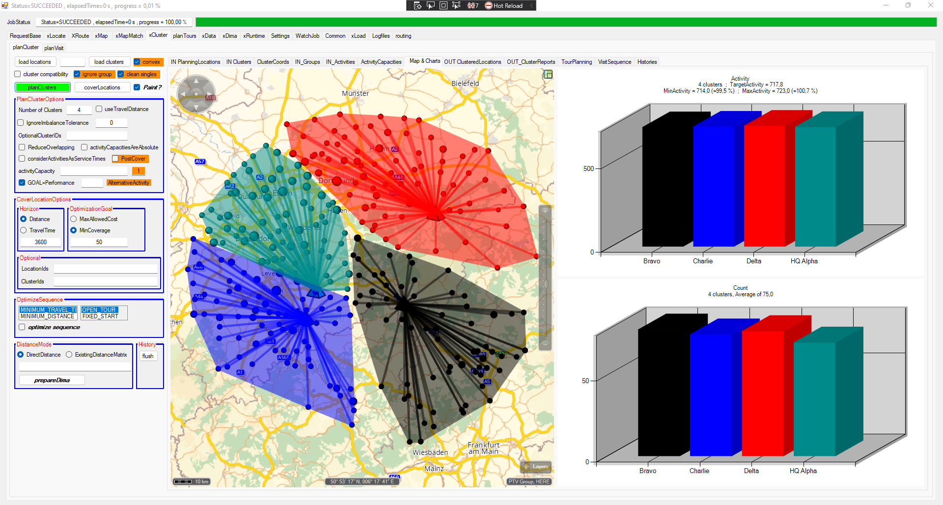

By setting the tolerance to 0% I really push towards the equality (risk of "no valid solution found")

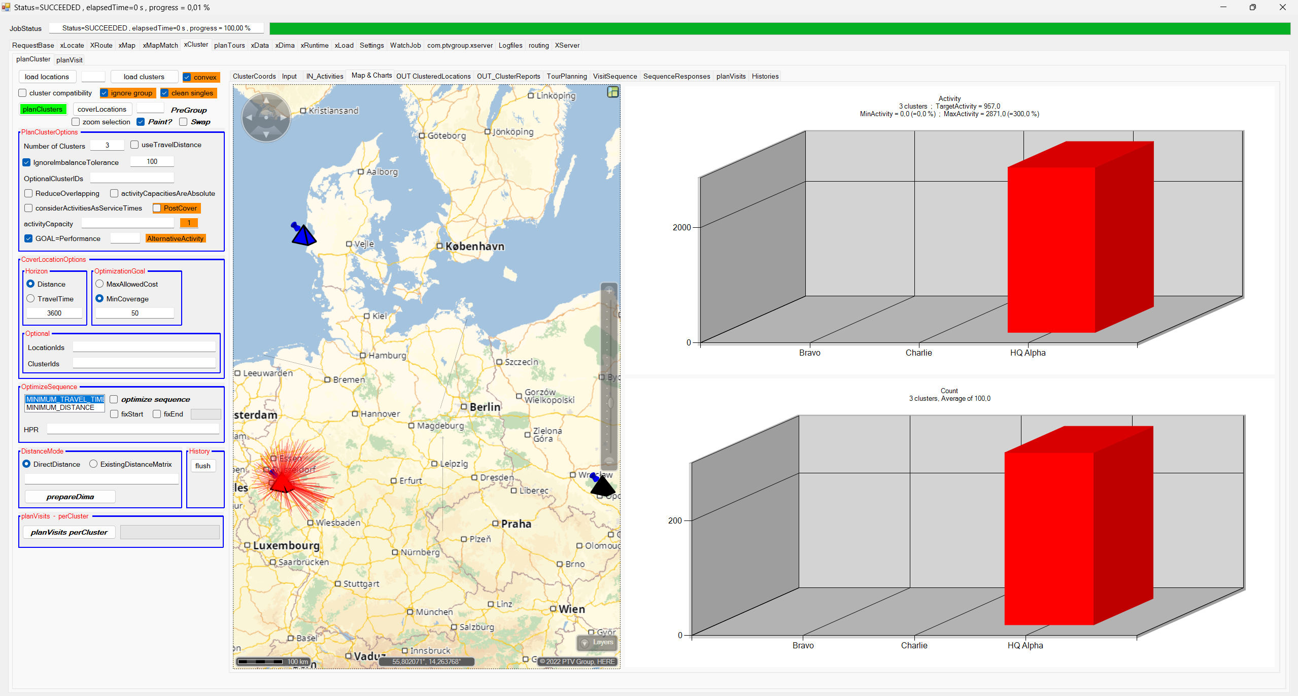

Here are some examples / edge cases based on "all orders are located in the area of cluster 1 and the total activity is 2'871":
ignoreImbalanceTolerance==true : all orders are assigned to the cluster 1 and stay within this cluster&quot;
ignoreImbalanceTolerance==true : all orders are assigned to the cluster 1 and stay within this cluster"

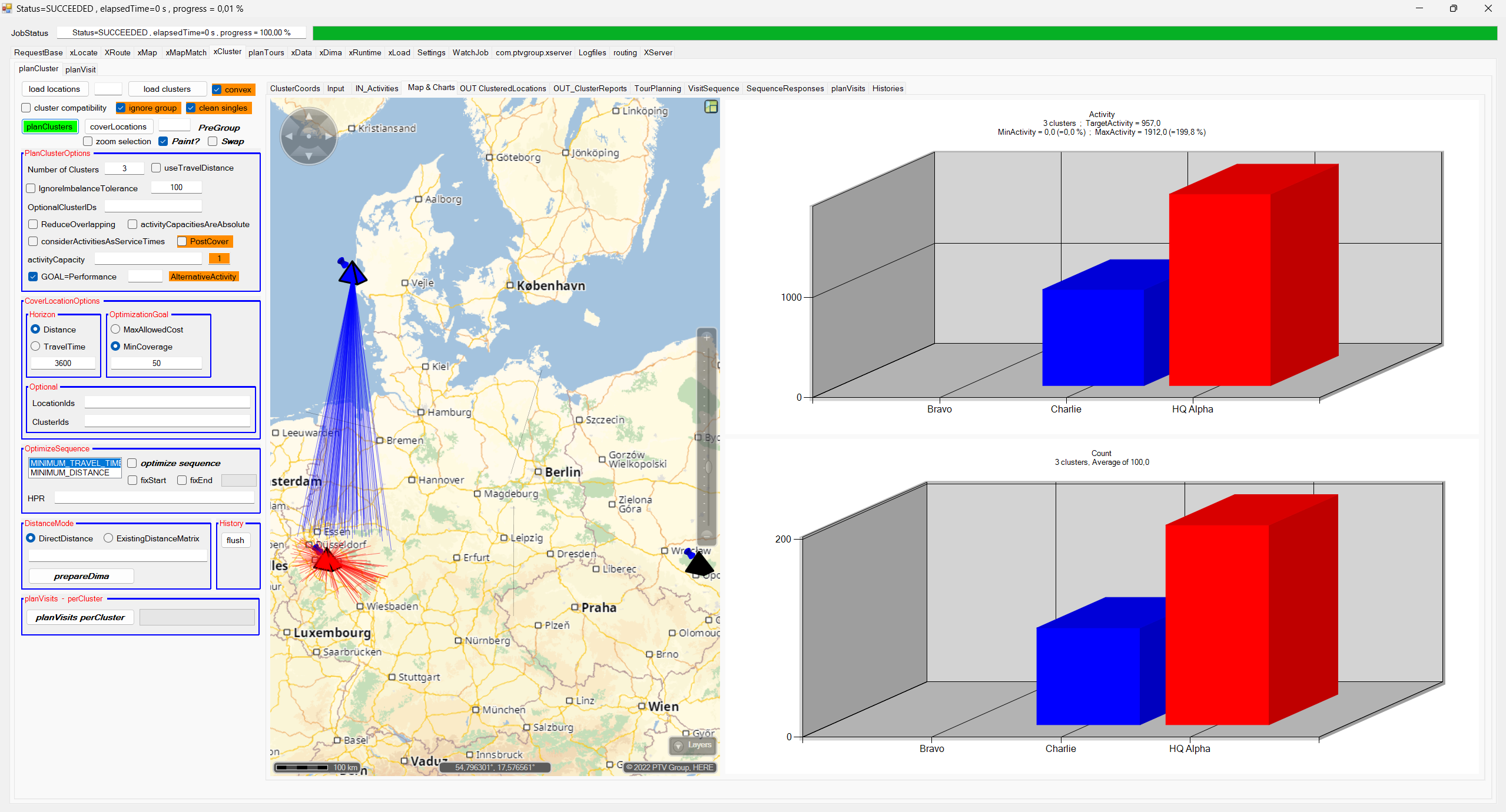

As the number of clusters is 3 the allowed range for a cluster is 0 to 957x2 =  1'914: so assigning all activity to one single cluster is not valid as this would overload that cluster.
