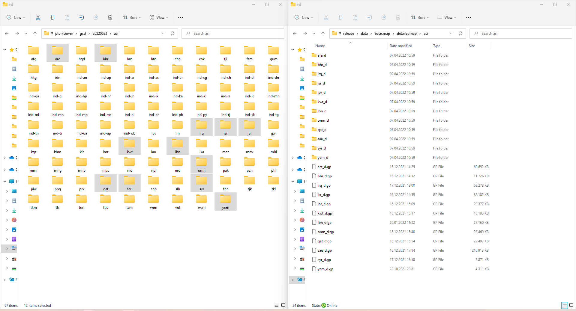

If you are running an installation based on a regional map and you are 100% sure that your client applications do not require countries outside a specific area you can also reduce the geocoder index:
Example: Arabia City map... required integration units
  • are - Arabic Emirates
  • bhr - Bahrain
  • irq - Iraq
  • isr - Israel
  • jor - Jordania
  • kwt - Kuwait
  • lbn - Lebanon
  • omn - Oman
  • qat - Qatar
  • sau - Saudi Arabia
  • syr - Syria
  • yem - Yemen
Manually assembled "Arabia City Geokoder index"
