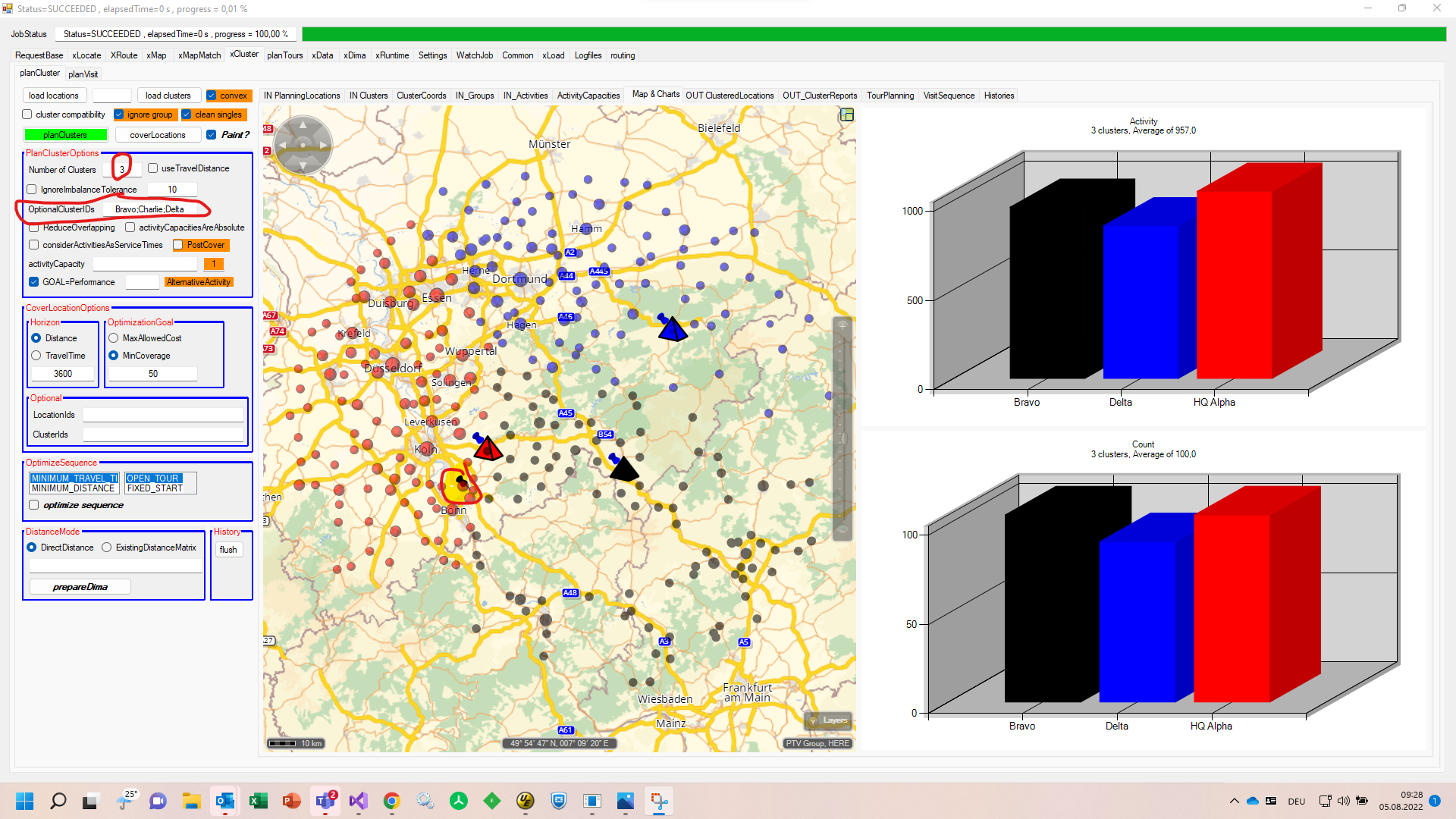

To solve this you have to proceed as follows:
  • Provide the 4 clusters as input clusters
  • Provide planClustersOptions.optionalClusterIDs = ["Bravo","Charlie","Delta"]
    As you can see in the map: there are two adjacent input clusters (blue pins) in the south west. The output shows that Charlie has been sacrificed.
