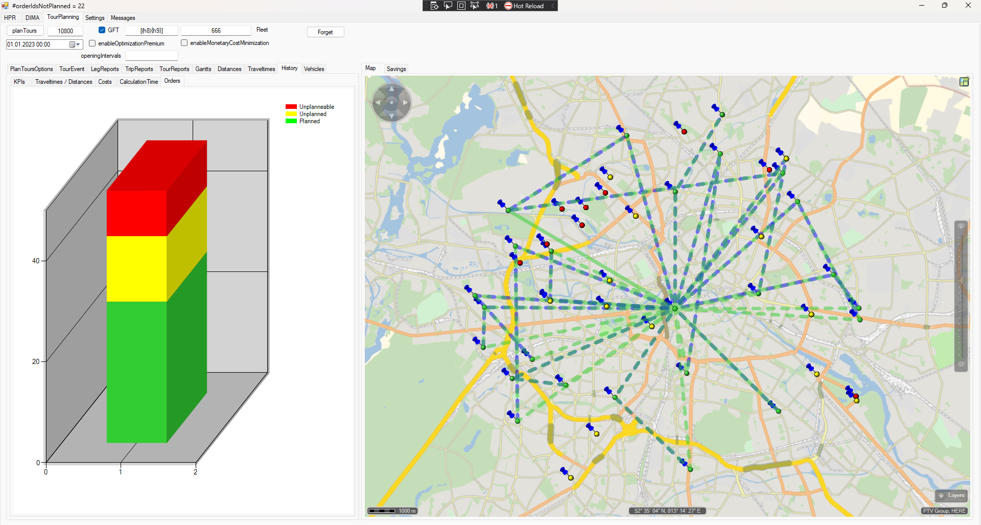

some of you may be familiar with xTour1 "unscheduledOrderAnalysis". This feature helped users to determin the cause for an order's unplanned behaviour as direct output of the planning transaction.
So here's the pendant within xTour2 - how to detect the reason for unplanned or even unplannable orders - check the chapter Analyzing Unscheduled Orders
:!: Please be aware that this might require several succeeding transactions and is based on the "storedRequestId" mechanism.
:!: Furthermore the strategy depends on whether you are analyzing plannable or unplannable orders:
Thanks to Daniela for that hint!
Green: scheduled orders<br />Yellow: planneable, but unscheduled due to workload / insufficient ressources<br />Red: unplanneable, e.g. due to routing restrictions
