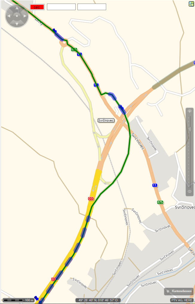

The original response - the green route follows a weird path. WRONG result due to insufficient data.

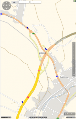

As you can see on this map the input coordinates (blue pins) are showing a gap of several hundred meters. The pin in th middle is located close to the minor road from north to south (while the proper route follows a track from south to north). There is an input coordinate given in the south of the highway exit but it is located too far away from the critical one. This could lead to a disruption of the sequence and this means that there's no ongoing history.

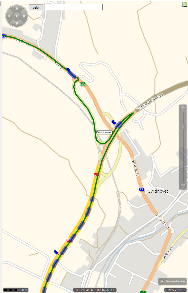

In this request/response I added a heading of 330 degrees to the critical coordinate and therefore the engine is able to switch to the proper path based on the national road in the east.
The overall situation in the area with the CORRECT route driven by the driver
