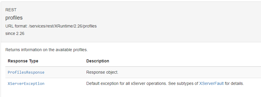

I just attended the sprint review and saw that there will be a new REST method in v2.26 (expected in april 2022):
screenshot from the DEV server (11.3.2022)
This will solve the profiles topic.
About the copyright string: that was new for me. I'll forward this internally.
