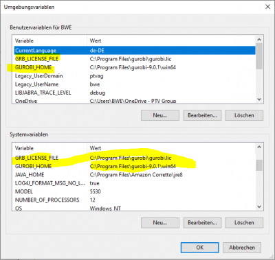

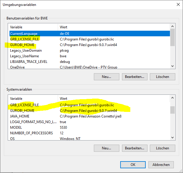

Once GUROBI is installed on your local system you have to configure ...
some system variables...

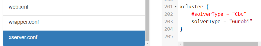

and tell the xserver.conf that you wish to use GUROBI instead of CBC
