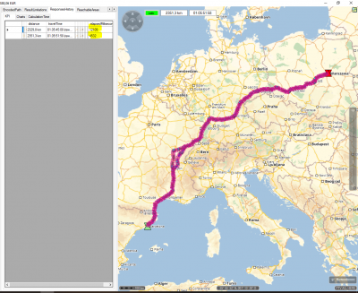

I did some tests and the calculation time dropped by about 50%. Of course I am very interested in applying this feature but:
What kind of non-optimal routes could I get? Can I get some more info about this?
Barcelona to Warszawa:dropped from 12 seconds to 4.5 seconds calculation time
