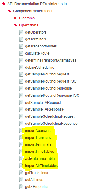

  • The number of intermodal objects in xRoute is fixed within the used map. In xIntermodal a user is enabled to import own data records for Agencies, Transfers, Timetables, Terminals, ...
    screenshot from the xIntermodal API
