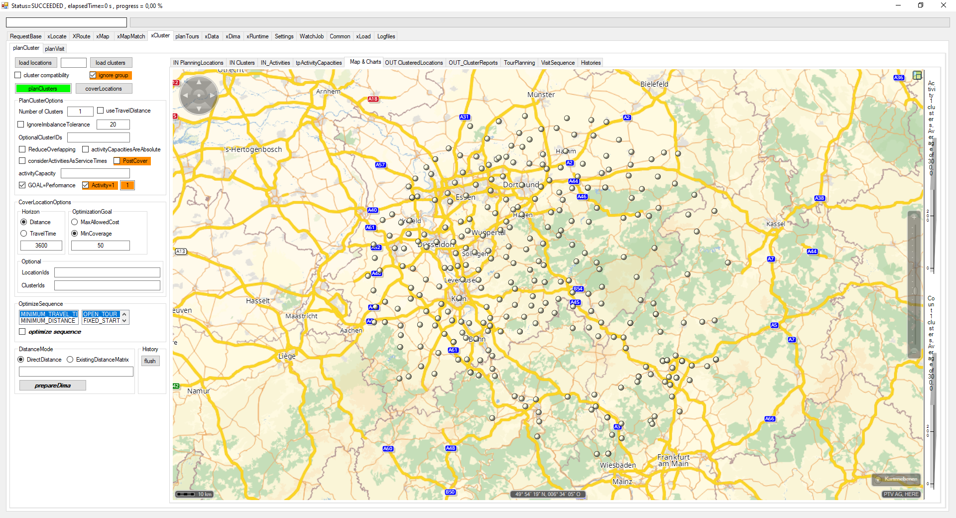

  • There are two major object categories. The first one is "the location" which knows (x,y) and also a value that is called "activity" (>0).
The sample customers. In this picture / first scenario each customer has an activity of "1". Therefore all icons are displayed with an equal size.

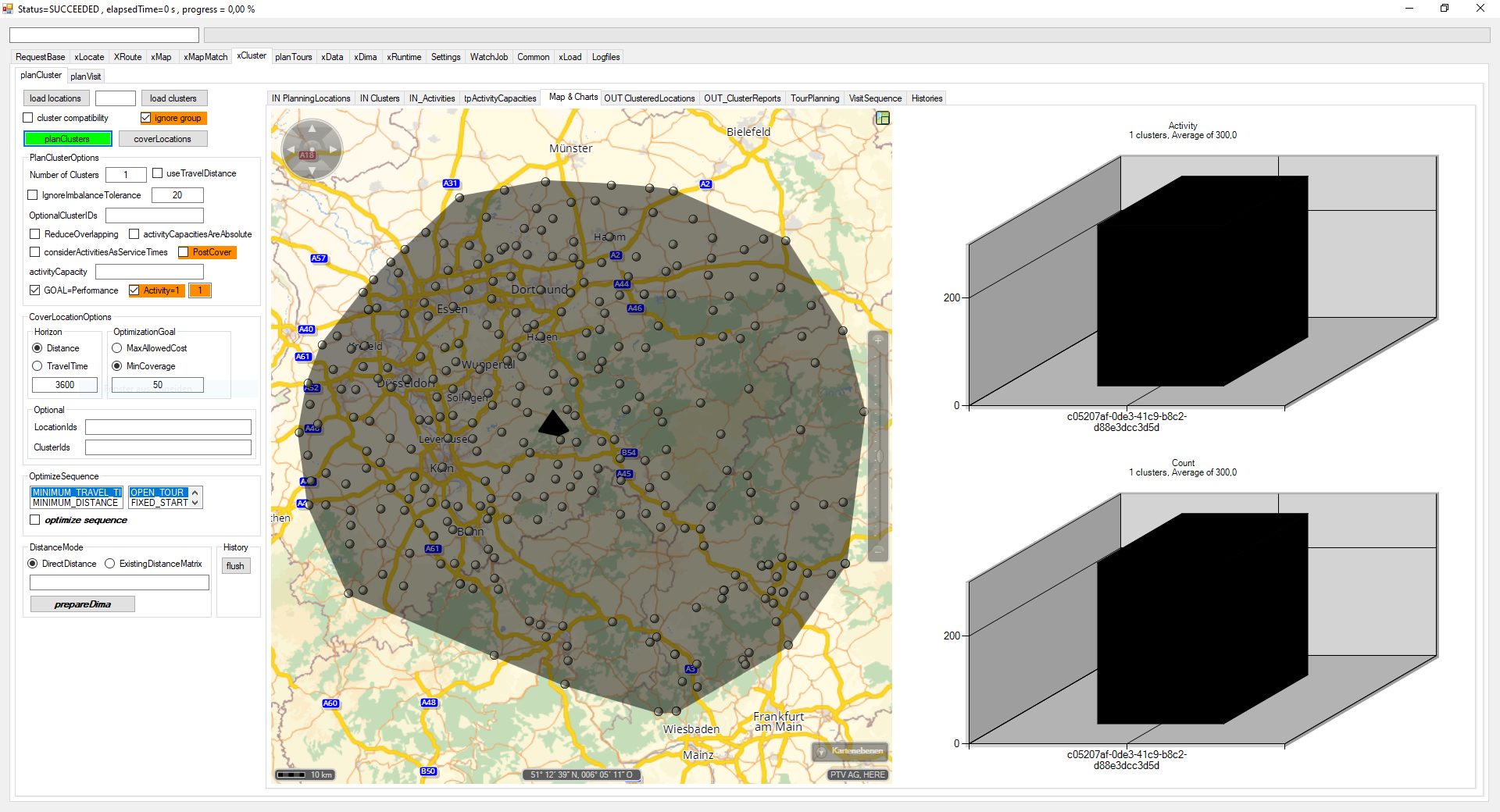

Example 1a - gravity center of the customers (activity = 1 for each customer)
Where is the best position to serve all the customers from?
The first output: the API tells you the position of this center of gravity. It is not just located in the geographic center of all the customers but a bit left because the customers are more dense in the west.

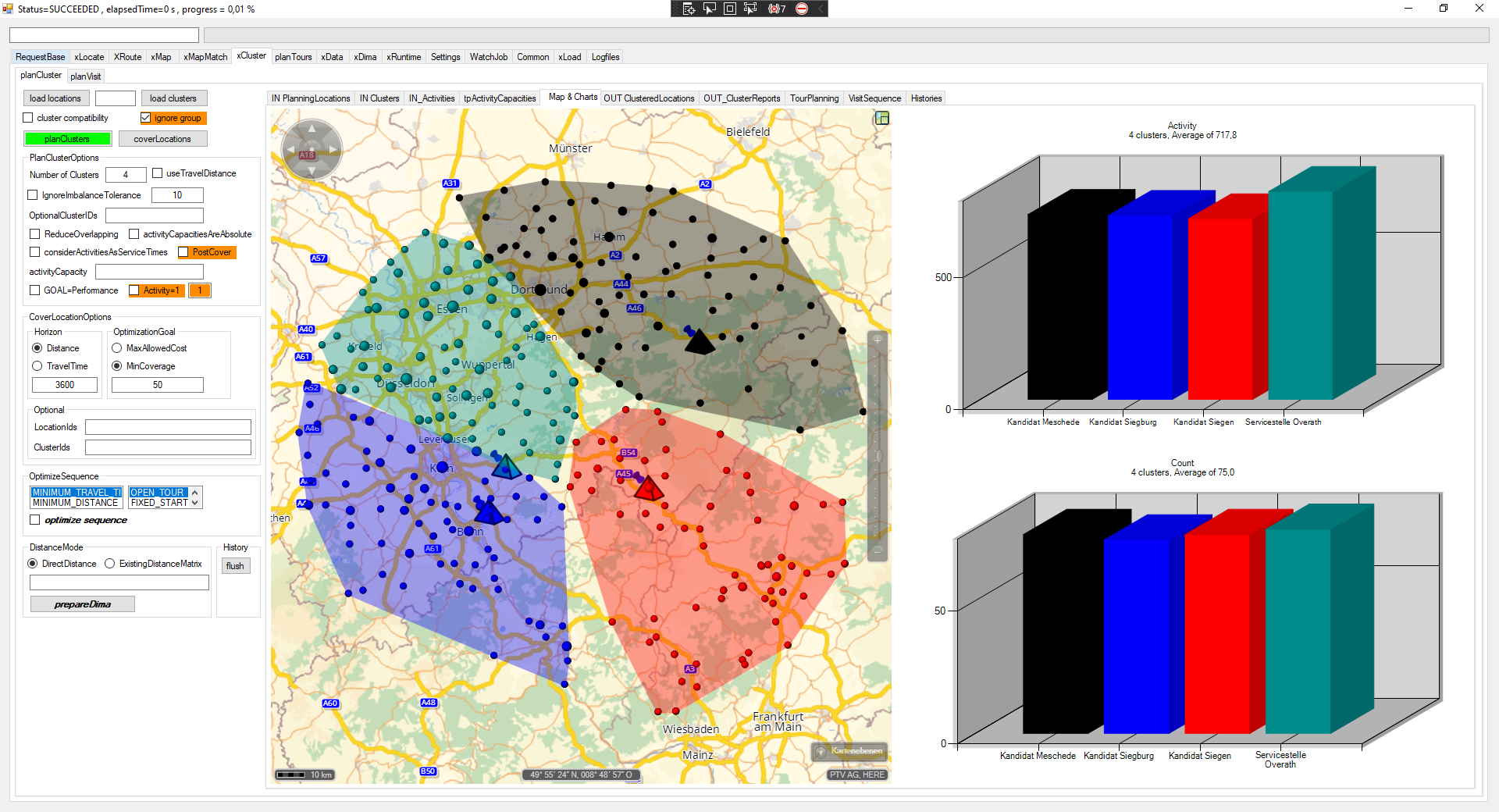

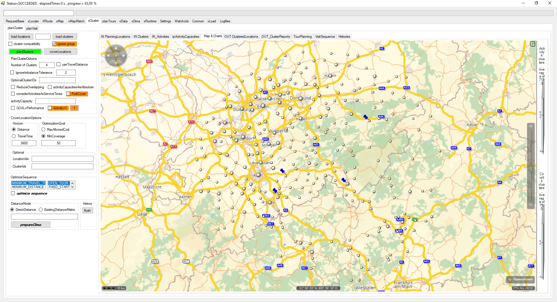

The next few scenarios will handle the four predefined territory centers (blue pins). The centers are fixed - I want the API to assign the customers by applying the compactness and the equal total activity per customer.
Each area is compact, each total activity is almost 25% but as two of the fixed input centers are locetd very close one of the centers is placed at the border of its territory.

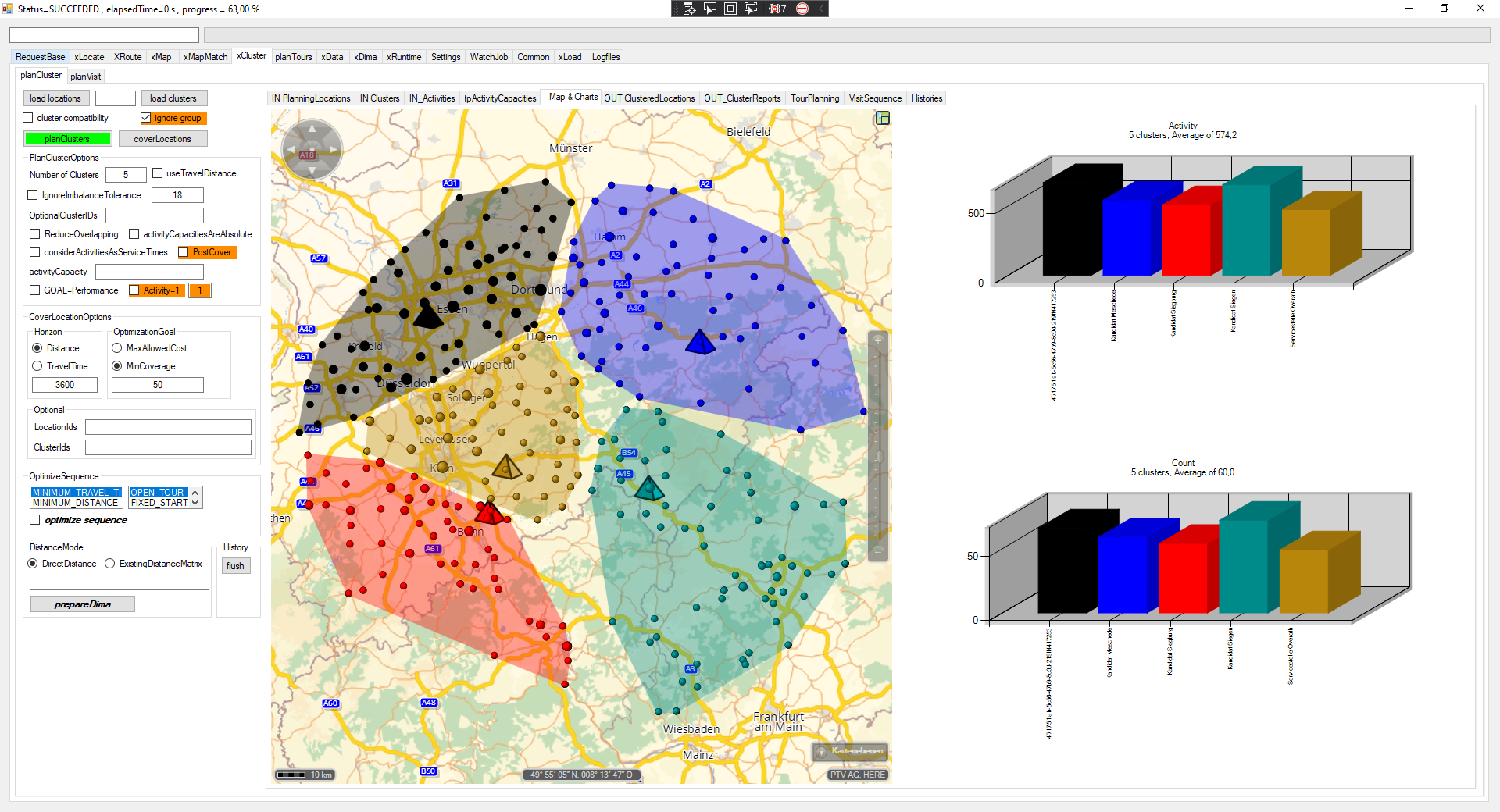

Here I provided 4 input centers but requested 5 output clusters so the API decided where to place the new 5th. center (black)

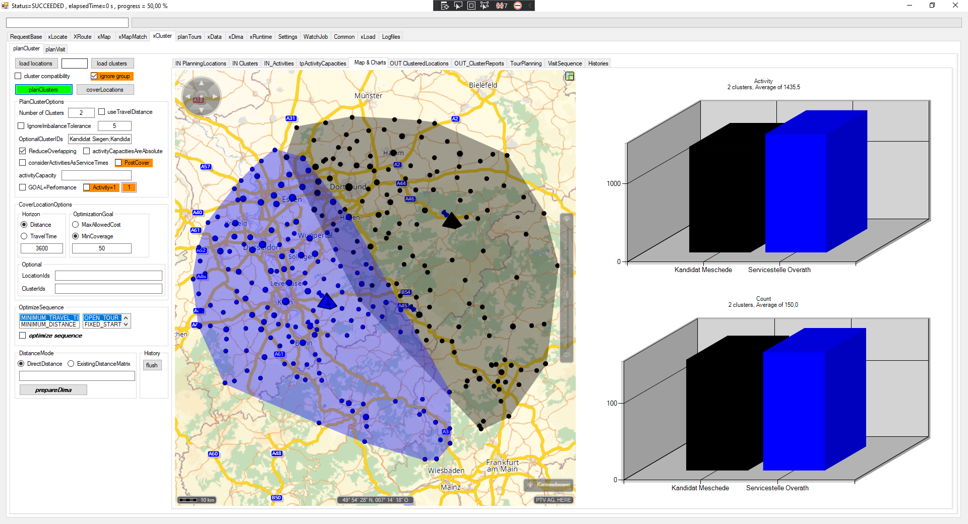

In this example I started with 4 input centers and asked for &quot;which ones aren't needed if I need 2 in the output?&quot;. I also mentioned that NW (=blue) is mandatory while the other three input centers are candidates for the sacrifice. As you can see from the blue pin (south west/south east): these centers are not part of the result (no pyramids). <br />They have been chosen as &quot;least needed&quot;. This is useful if you have existing centers (predefined) and several candidates for new centers to be opened.
In this example I started with 4 input centers and asked for "which ones aren't needed if I need 2 in the output?". I also mentioned that NW (=blue) is mandatory while the other three input centers are candidates for the sacrifice. As you can see from the blue pin (south west/south east): these centers are not part of the result (no pyramids).
They have been chosen as "least needed". This is useful if you have existing centers (predefined) and several candidates for new centers to be opened.
