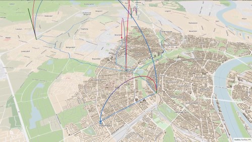

PS: Here are some examples I found on our own pages (list will be extended). Maybe we should set up a gallery ;-)
And by the way: the tilted / rotated background maps are provided by the brand new PTV Vector Maps!
based on https://deck.gl/  +  PTV Vectormaps

Hi Max,
technically you have three components for these visualizations: A vizualization libray, a map control and a basemap tile provider. You can use nearly any combination, e.g.
(deckgl/d3) - (maplibre/leaflet) - (VectorMaps/RasterMaps)
I adapted some samples from https://deck.gl/examples/ visualizing arcs and lines to PTV developer maps.
https://jsfiddle.net/oliverheilig/psjq4neb/
https://jsfiddle.net/oliverheilig/u9fn15t0/
Here the stack is deckgl-maplibre-VectorMaps, but you could also use maplibre with raster maps and xMapServer as shown here
https://ptv-logistics.github.io/xserverjs/#boilerplate
A prerequisite of all these solutions is a web browser. If you need to include this into a desktop application, you could use some WebView approach. Here is a sample using "Chromium Embedded Framework (CEF)" in a WinForms application.
https://github.com/oliverheilig/CefMap/
So this is the state-of-the-art technology. I hope I didn't confuse you too much.
