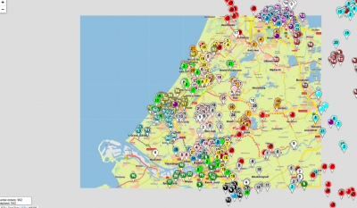

This year we made the step of using Leaflet instead of ajaxmaps.
All is working is fine but we notice that when are zooming out in the map, we see a lot of gray parts.
We are using xServer version 1.32 on premise.

What can I do to increase the performance of the rendering? So less gray parts are shown.

Hello Lanzo,
my first question regarding this topic: how many backend mapping modules are in use?
Are you aware of this post: https://xserver.ptvgroup.com/forum/view ... f=15&t=972
