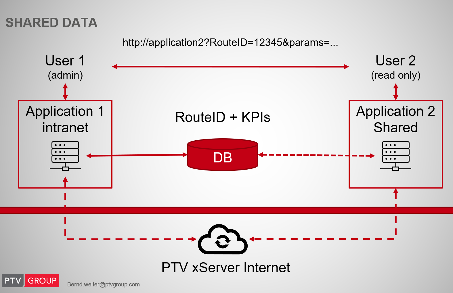

We calculate information such as routes with PTV APIs. The output is then displayed in our application. As a nice extension I would like to share the result with some other players in a read only mode (can't change the route itself) but with a level of interaction (user can view the route in a map and zoom in/out and so on. What we would like to have is a sharing mechanism where we send a URL to the recipient that he can immediately access the desired content.
Let's look at the following slide:
  • On the left side we see the leading application that is used by the admin who "creates" content by using our PTV xServer (or to be more precise: PTV xServer Internet).
  • The content is consumed and some of the data is stored in the clients database (not at PTV!)
  • Based on some primary key elements of "the content" the URL is created and shared with the read only user
  • He connects to a second (web) application which has access to the client database
  • The second application uses the "primary key" to identify the relevant content in the client database...
  • and then produces the user interface which displays the content in read only mode.
This overview should give you an impression of how to build this within your scope - whether you are an end customer or a partner.
