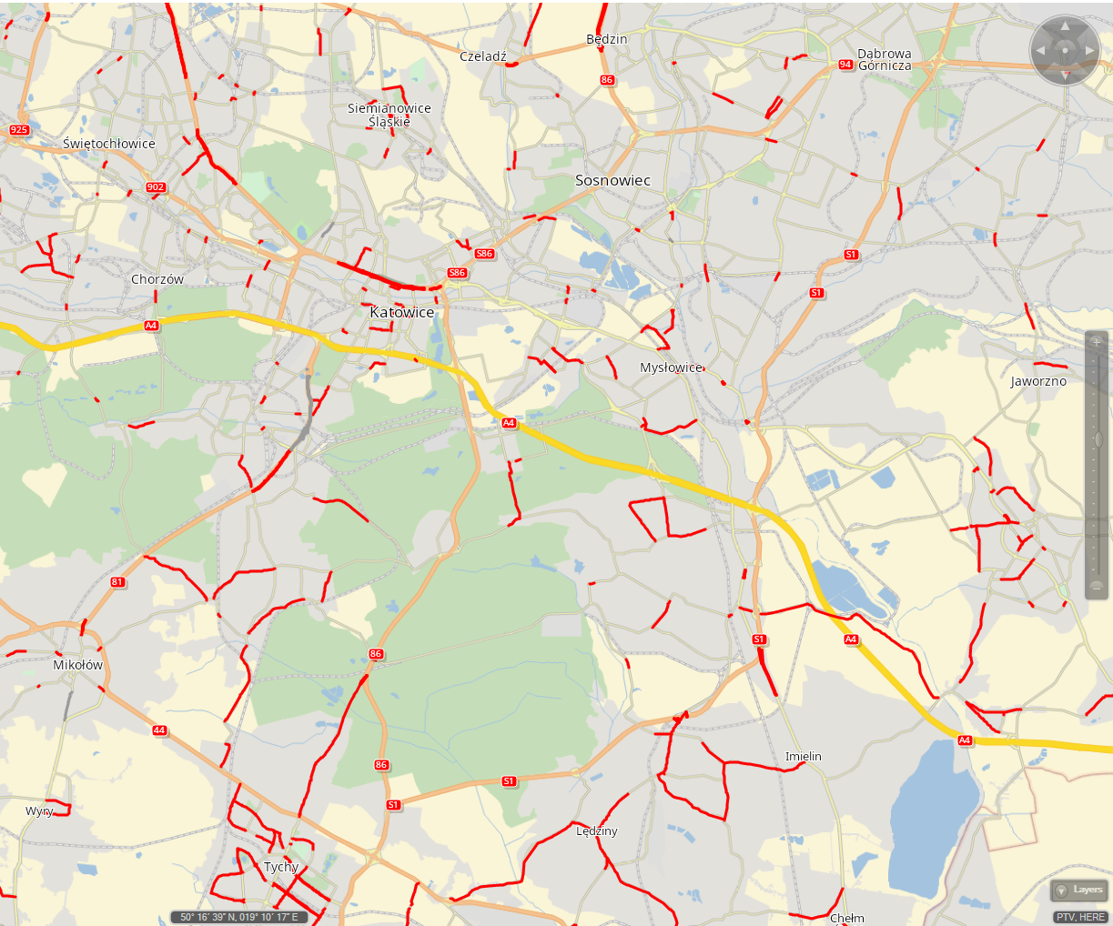

To show restriction signs on map we add PTV_TruckAttributes to LabelTehemes (formsMap1.Xmap2LayerFactory.LabelThemes.Add("PTV_TruckAttributes");. But when we add this, API adds on map not only restriction signs, it also draws red road on road with restrictions for trucks. So we tried adding dimensions and weight in default.xml.
<weight emptyWeight="1.0" loadWeight="1.0" totalPermittedWeight="2.0"/>
<dimensions height="1.0" heightAboveFrontAxle="1.0" length="1.0" width="1.0"/>.
We thought that it would help, but it doesn't. Is there any way to display only restriction signs without red roads?

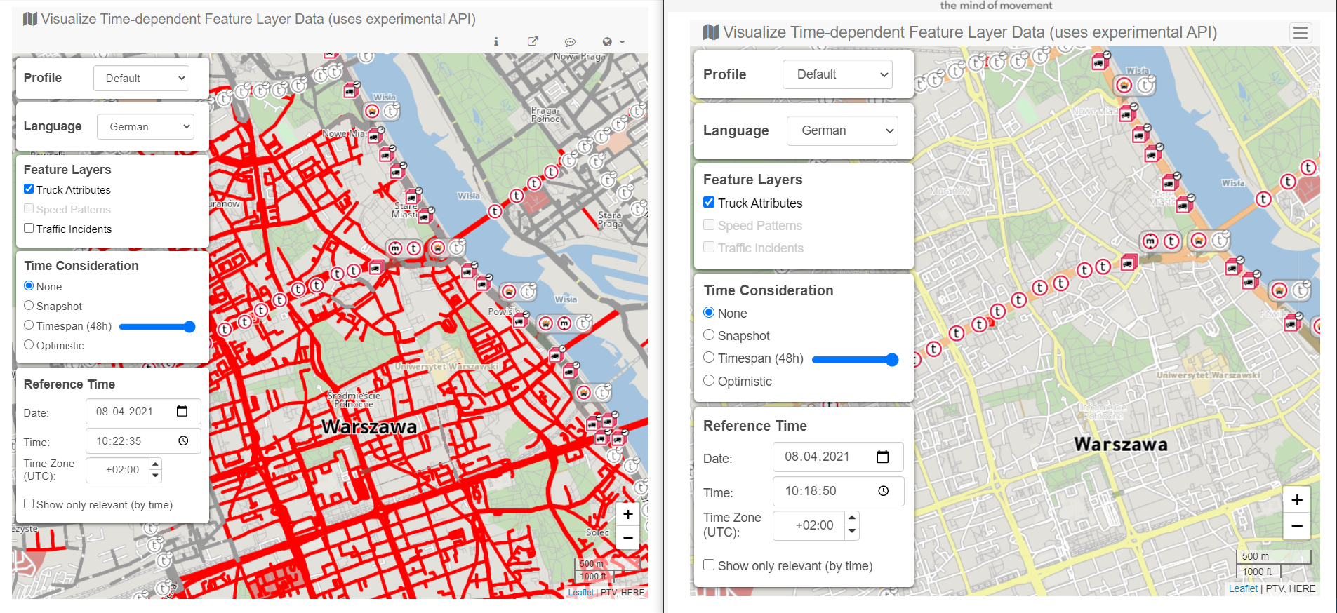

I made some experiments with my local instance of v2.22. I changed the /profiles/rendering/featurelayer/fl_truckattributes.xml as follows:
I replaced "<stroke color="#FF0000" opacity="100" width="90%"/>" with "<stroke color="#FF0000" opacity="0" width="90%"/>" various times. Now the inner city of Warszaw looks different:
left: xServer Internet with default settings for PTV_TruckAttributes<br />right: my local version with the transparent lines
Does this solve the problem? This is obviously a hack that works in an on premise system.
Haven't tried to apply this via request.
