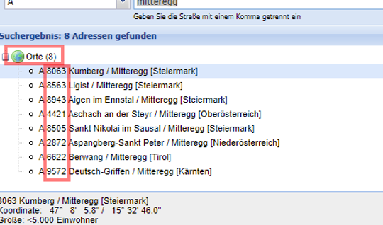

recently I've been approached by a customer with the following topic:
The geocoding output in Map&Guide Internet (MGI) differs from the xLocate 2 output:
Search for "Miteregg" in Austria. MGI / xlocate 1 returns hits including postcodes.

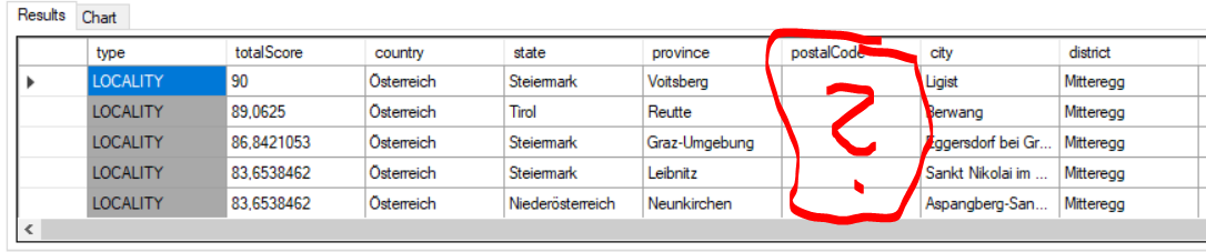

xLocate 2: The same input returns hits WITHOUT postcodes. They are all categorized as LOCALITY
The main reason for the difference in the behaviour of the two applications is the engine used in the background:
  • MGI uses PTV xLocate Server (22.3.2021)
  • XServer2 uses PTV xLocate Server2
The philosophy of xLocate 2 differs from the old approach and by entering a single town name or district does no longer return all postcodes in the area but just rough localities which represent the hit.
Furthermore the new engine does not provide the same number of confusing parameters as xLocate1 did (caused too many discussions, was too difficult to explain). XLocate 2 development simply reduces the number of parameters to a meaningful minimum.
From our perspective neither xLocate1 nor xLocate2 is wrong - they are just different.
