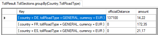

these days a partner asked me how to determine the toll distance per country in xRoute2.
What he encountered was that the Toll and it's list of TollSections does not always contain an "officialDistance".
TollSections with the official distance (Germany only), though all the three countries return toll prices...

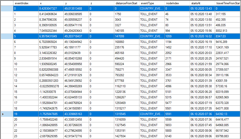

  • Request both the CountryEvents and TollEvents
    RouteEvents
    RouteEvents
  • Iterate over the events and "memorize" the current country

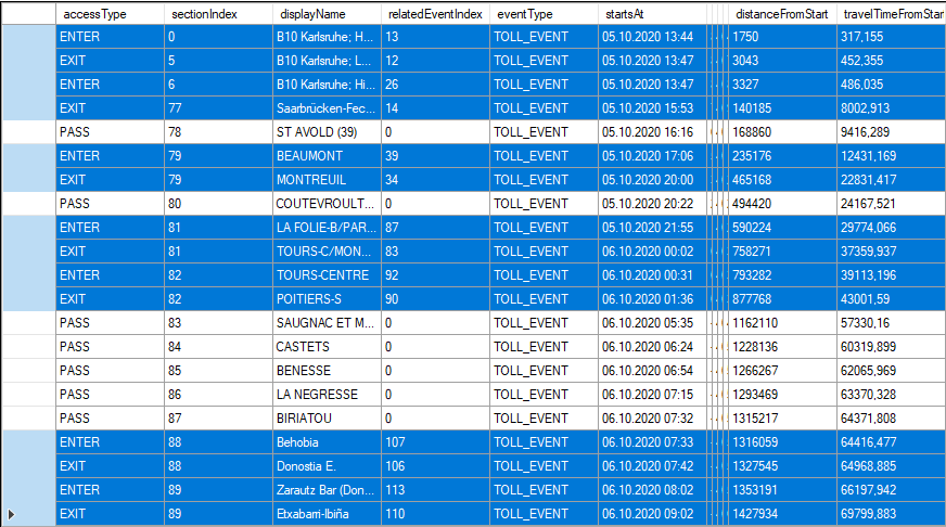

  • Collect corresponding ENTER and EXIT TollEvents based on the AccessTypes
    TollEvents
    TollEvents
  • Determine the length of these "inofficial" toll sections by subtracting ExitEvent.distanceFromStart-EnterEvent.distanceFromStart
    Computed distances...
