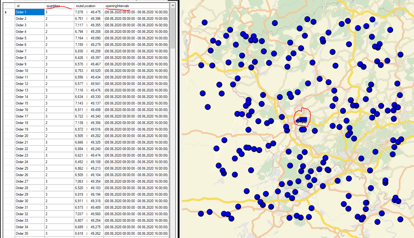

  • Imagine a central depot where all the parcels are located and ready for processing. You know the shipping addresses.
  • Optional: the weight and dimensions of each parcel. Maybe also some service level based "deliver before HH:MM" constraints.
  • To fullfill the orders you have a fleet of vehicles (Heterogeneous? Homogeneous?) with specific capacities
  • and a team of drivers.
  • Furthermore there are some additional constraints such as "drivers should not work more than hh hours..."
  • Though we can also deal with equipment / skill.sets let's just ignore this for the beginning.
  • The core challenge in one sentence: determine the assignment of parcels to vehicles/drivers and the delivery sequence. Ensure that all constraints are considered. I assume that we plan everything from scratch - so there are neither initial assignments nor sequences.
There you go - let's model this with the xTour2 API. The objects we need for this are:
  • The required method from the xTour2 API is a PlanToursRequest.
  • For each destination (or pickup address for returns) we need a location of type CustomerSite. Usually a CustomerSite per (x,y) is sufficient. You may need two separated CustomerSites for the same (x,y) if two orders have to be shipped to the same address but within independent opening hours (driven by the SLA).
  • Furthermore we need a location of type Depot.
  • Next thing to check is the orders. Usually we would need PickupDeliveryOrders which means there's a unique pickup and a unique delivery location and you can refer to the location IDs provided in the objects mentioned above. For a regular shipping the pickupLocationId is the Depot's ID and the deliveryLocationId is the CustomerSite's ID. For returns it is vice versa. At this step you could already mention the quantity of a parcel if this information is available. Furthermore y<ou can specify how much time is required for the picking or delivery.

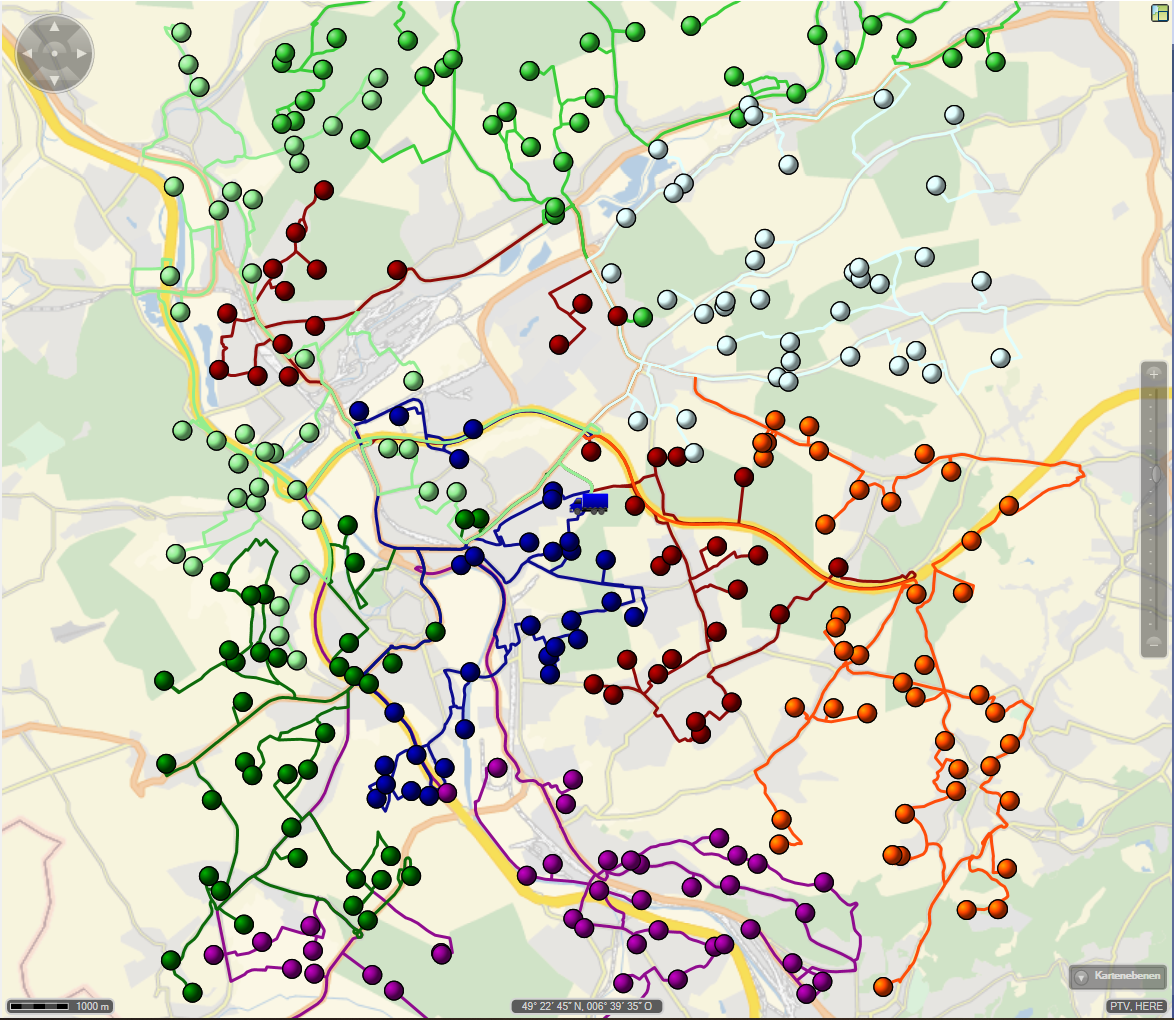

    The result of the planning is based on routed distance matrices though the map connects the orders through airline. Usually this visualization is sufficient for a dispatcher and shows the sequence of the stops in the output.
    If you want to display the precise geometries of the routing polygons after the optimization call you can process each tour/trip through xRoute to get the geometries.

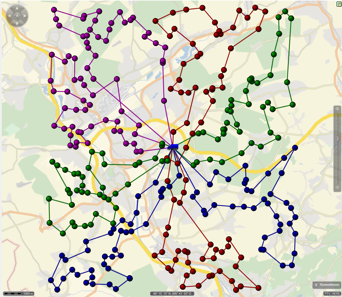

Now here we are: call the PlanToursRequest and look at the ToursResponse: it contains a list of Tours (one tour per used vehicle ID). WIthin each Tour you find a list of Trips, within the trips you find the Stops and within each stop you get the tasks such as loading, unloading... So this is the info you need: who takes care of what in what sequence...

PS: Both tour results are equal - just the visualization differs!
