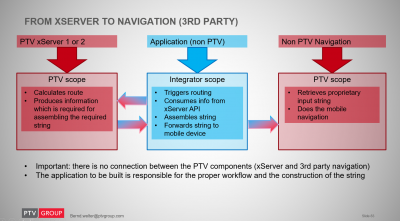

Every once in a while I am getting asked for whether PTV routing can provide files that are ready to be used with non-PTV navigation products such as Google Maps (©) or Cygic(©). Of course each one of those players requires a proprietary file format so what PTV xRoute can offer is to return the info that is needed to create such a file, e.g. all the polygon points.
What we do not support at the moment (august 2020) is s a direct output you can forward to those other systems. You would need to assemble these strings manually but afaik the level of complexity is way less than rocket science ;-)
simple workflow chart
In most cases you simply need WGS84 coordinates of the waypoints (stations) or maybe all the detailed polygon points. We can provide both of course.
