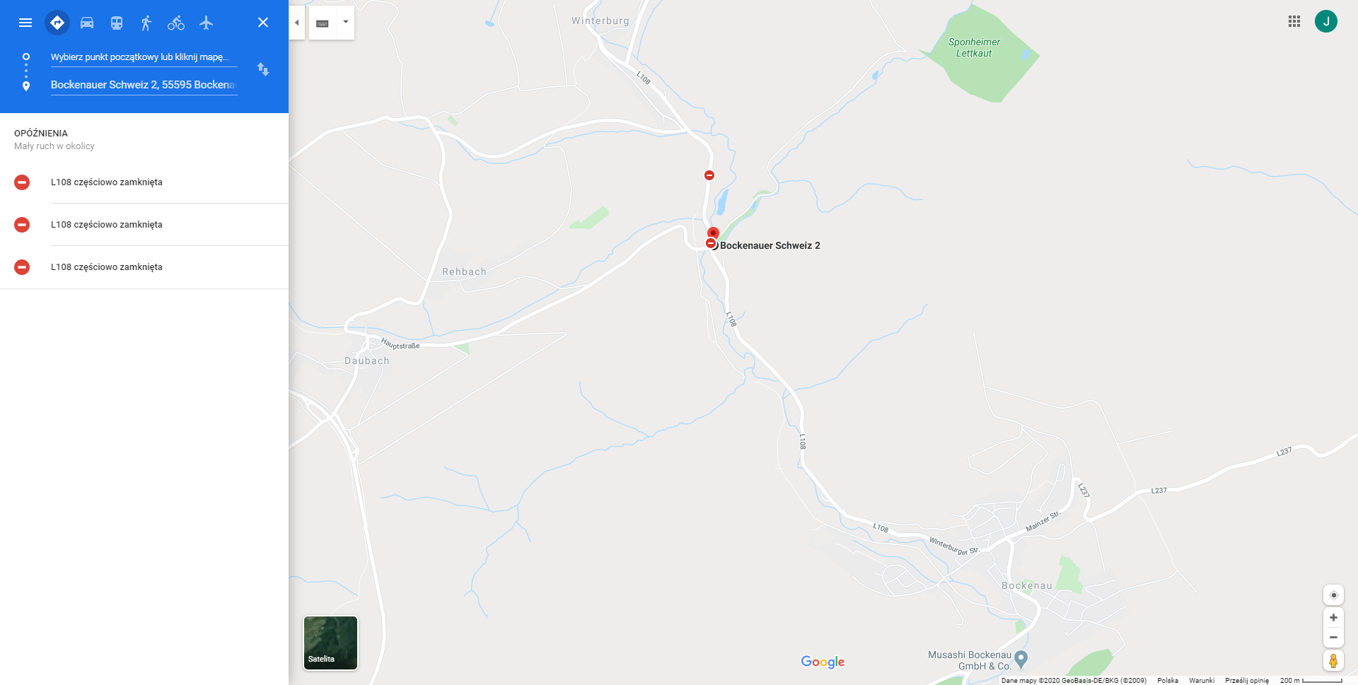

One of our clients delivers goods to construction sites. In some cases, these roads are temporarily excluded from traffic, requiring a special entry permit.
These routes are generally imposed by the customer. So we need to find a solution that will allow our client to route through these sections that are temporaily unavaiable for traffic.
The questioin is, can we distinguish between temporary entry bans and permanent entry bans ? Are they controlled by the same parameter ?
The most desirable outcome would be a possibility, in which we could ignore the temporary no entry signs while calculating routes.

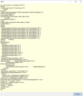

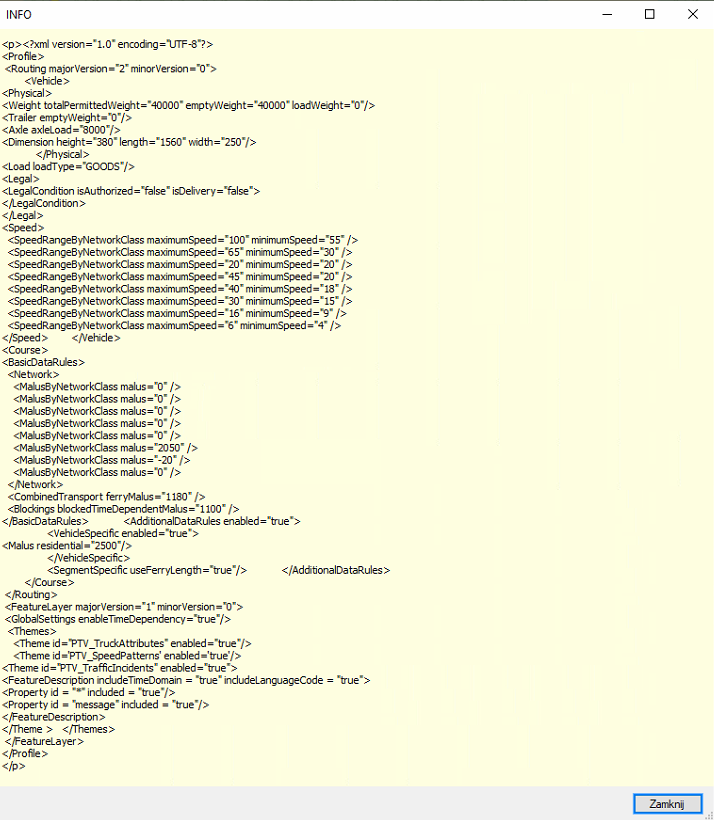

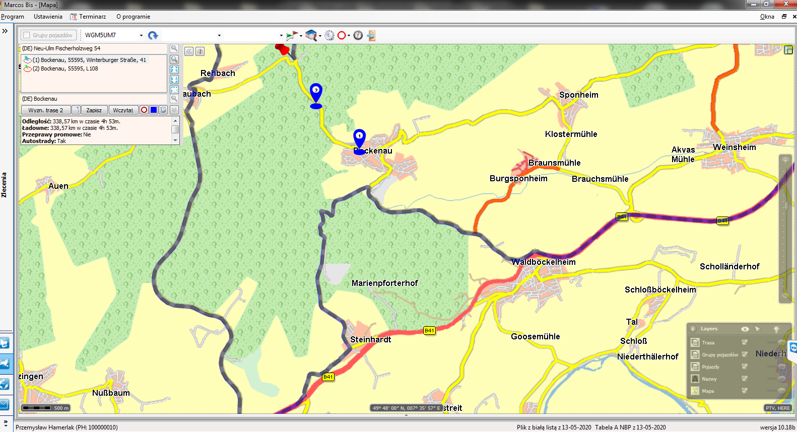

The street does appear on the map and none of FeatureLayer used seems to be a problem. While calculating route we also dont use mentioned core properties (isBlockedForTruck, isBlockedForCar). In the attachment i am sending you our parameters.

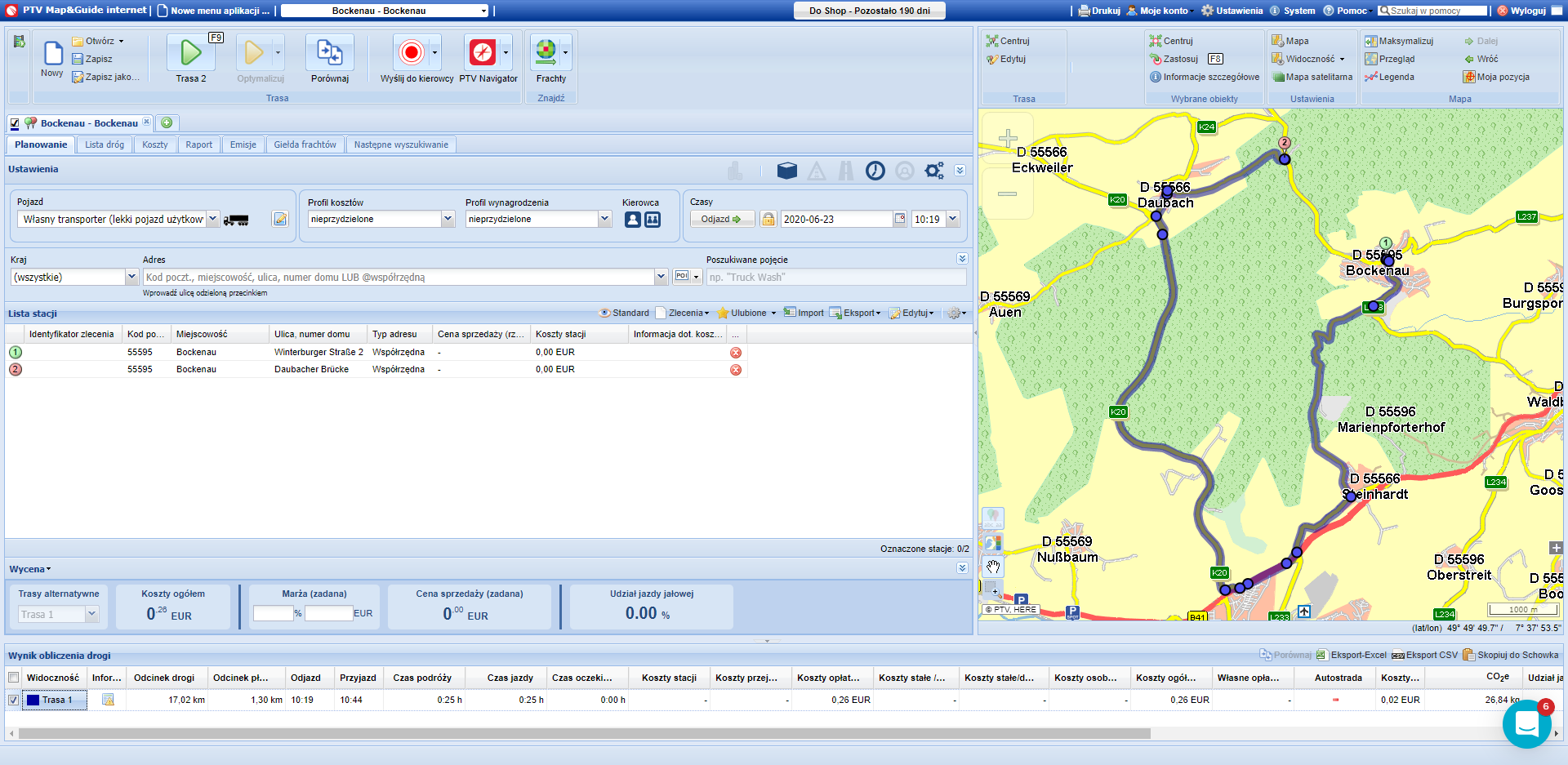

As of yesterday I've got an access to your Map&Guide Internet. Calculating the route with the "Activate truck restrictions" option turned off, doesnt seem to have any effect. Therefore i think we indeed are having an issue with core properties which are isBlockedForTruck and isBlockedForCar
Could you suggest some solution to this problem ?

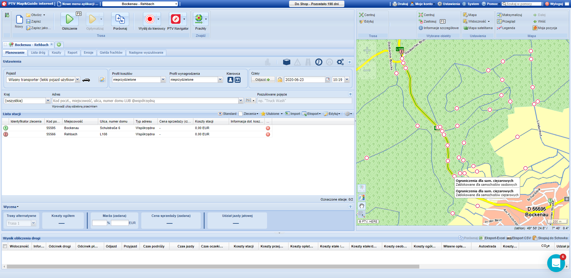

Re: Routing problem : Access to the construction site
Looks like the section you mention is in fact blocked for regular traffic (message in german only):
https://lbm.rlp.de/de/aktuelles/detail/ ... interburg/
I'll ask DEV about how to handle this. Please remain patient
