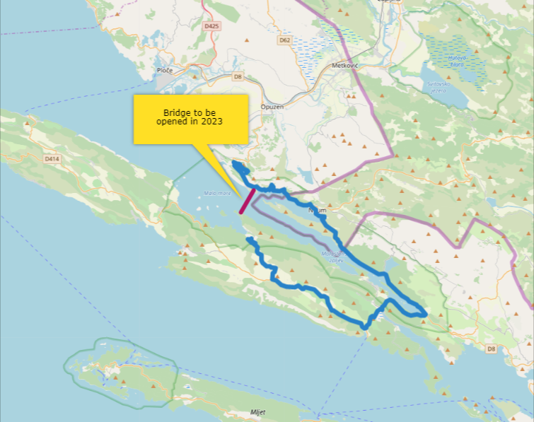

Is it possible to calculate a route or matrix taking into account a bridge (or road) under construction - with an opening date already set?
I'll give specific example. Pelješac Bridge is scheduled to be opened by the end of 2022 - https://en.wikipedia.org/wiki/Pelje%C5%A1ac_Bridge. Currently, PTV is not using it whith start time set on 2023-01-19 (see attachement).
I used the `calculateExtendedRoute` method (API v 1) with parameter
    "parameter": "START_TIME",
    "value": "2023-01-19T03:14:07+00:00"
The map used is "PTV World City Map Premium 2020.2H".
The result is not surprising and I don't think it's a mistake, I just wanted to confirm my guess.
I wonder if there is an option to include planned bridges / roads? Or is the PTV data only updated when the routes are already open?

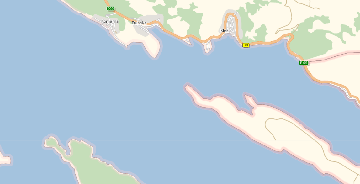

I've witnessed such future sections with a scope of 1.5 years but not with three years as the one you refer to in your example. In the map you used the bridge is not even visible, right?
Region near Neum/Komarna
I therefore guess we will add the geometry in a future version (incl. "closed") and in another succeeding version we will remove the "closed" and replace it with a "open".

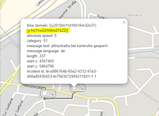

Another approach to consider such projects would be "long term traffic incidents":
long term traffic site in Karlsruhe/Germany: started in nov2018 the project is supposed to require almost 2 years. In such a case we can handle this properly, even including the time dependency: by requesting a route in 2021 the segments will be open. For now they are closed. So it depenmds on the data.
But of course we can only apply attributes to segments that exist in a map.
