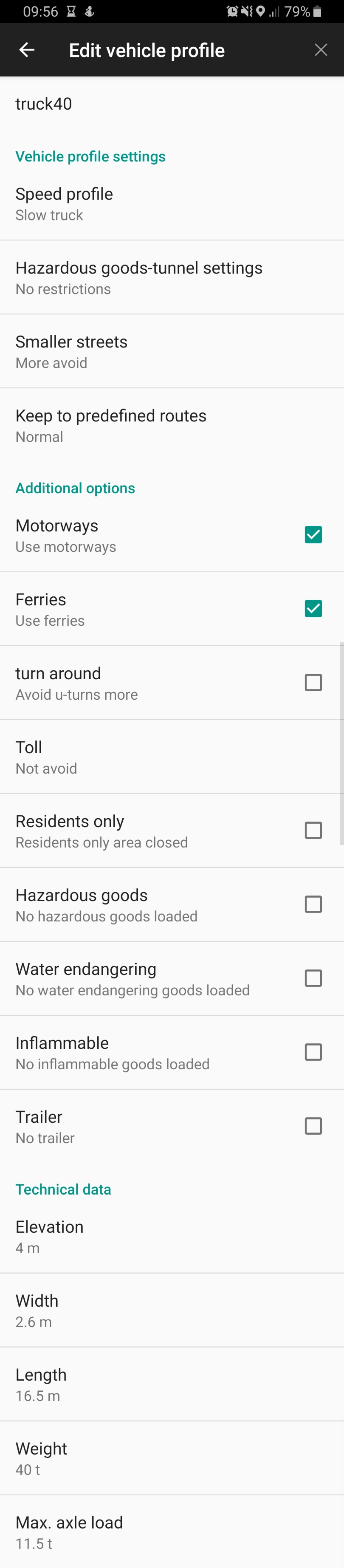

Where to find routing profiles?
afaik the routing profile parameters set in the user frontend are stored in text files.
  • Where are they located in the structure of the Navigator?
  • Can we get a documentation of the structure of the files?
Sample profile in the app

Routingprofiles can be found in the following folder:
Android/data/com.ptvag.navigation.app/files/profiles
Be aware that package names can differ. Each reseller has an own package name.
For example: com.reseller.trucknavigation.app
The general structure of a profile file looks like this:
[TruckProfile]
AmountIgnoredTiles=10
Anlieger=0
AxleLoad=90
ClassOfDangerousGoods=A
CostUTurns1=8000
CostUTurns2=480
HasTrailer=0
Height=40
IsExplosive=0
IsHazardousMaterial=1
IsLorry=1
IsWaterEndangered=0
Length=0
MautType=0
OverWriteProtection=0
Profilename=LKW400
RoutingOption=1
StreetPreference=1
TruckTollLevel=0
UseFerries=1
UseLearningETA=0
UseMaut=1
UseMotorways=1
UseUTurn=0
VehicleType=6
Weight=400
Width=26
WriteProtection=0
