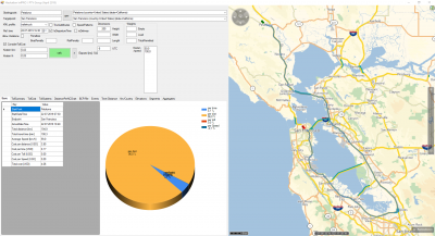

Here are some examples... I just played with the costs per hour and costs per kilometer.
Price per kilometer and Price per hour are expensive. Therefore the router looks for a short/fast track and is willing to pay the 40 $ for the Golden Gate bridge

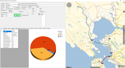

A medium price level is a good argument to perform a little detour around the Golden Gate bridge (40$): <br />The Bay Bridge toll price is 25 $

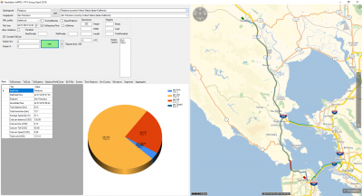

Now within this scenario the price per kilometer and the price per hour is very cheap which allows us to perform a very large detour to avoid each and every toll object.
