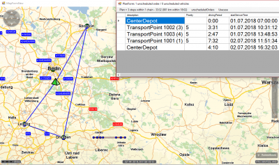

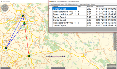

xTour1 provides a vehicle property "toursMustFitIntoSingleOperatingInterval":
  • toursMustFitIntoSingleOperatingInterval=true: the vehicle has to return to the depot by the end of an interval. This is what happens if you restrict the driver to return on a single day.
    Driver has to return on each day. Therefore two tours are created
  • toursMustFitIntoSingleOperatingInterval=false: the vehicle doesn't have to return within each interval but is allowed to stay outside.
    Driver can remain away from the depot at the end of the first interval.

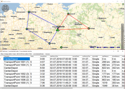

  • Furthermore we even offer a specific usecase or method which is called planOvernight: this special function decides on a financial base whether staying outside is better (compares distaance based savings with additional hotel based costs).
    Overnight usecase: Hotel cheap but TUESDAY belongs to family (want to be home)? Two partial tours: <br />tour 1=MON morning to TUE evening.<br />tour 2=WED morning to FRI evening.
