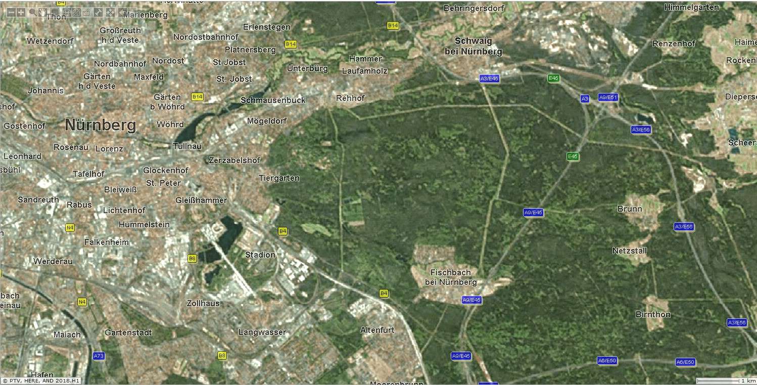

we test the Here Satellite Images in our program. When i only activate the Here Satellite Images, it works fine. But when i activate the Featurelayer PTV_Truckattributes too, the background of the Truckattribute lies over the Here Satellite Images (see attachment).
Is there a posibility to deactivate (transparent) the background of the Truckattribute-Layer. I tried it with the profile silksand.ini, because the name of the featurelayer-profile is silkysand-fl-truckattributes.xml, but it doesn't work.

- Posts: 2863
Re: Here Satellite images and PTV Truckattribute
Good morning Jürgen,
I received an explanation from one of the experts - enriched by a statement by myself:
The described behaviour is caused by a technical restriction within FeatureLayers:
FeatureLayer lines will only be drawn if streets are visible. Therefore the Ajaxmap is implemented as follows: if a FeatureLayer is active use the Ajaxmaps background profile instead of the foreground profile (which does not display streets). This causes the side effect of the non transparent layer which overlays other layers, e.g. the satellite layer.
Hello Bernd,
thanks for the info.
I try to deactivate the Truckattribute-Layer, when the satellite-map is "on". But I have Problems, to get the click-Event from the Toolbar.

- Posts: 13
- Joined: Tue May 13, 2014 3:28 pm
Hi Jürgen,
you should be able to hook into the satellite layer and check when it's enabled/disabled (which happens in the end when you click on the toolbar buttons):
Instead of "sat", use the name of your satellite layer. Instead of the alert, turn the feature layer on/off.
Andreas
Hello Andreas,
thanks for your sample, works fine.
